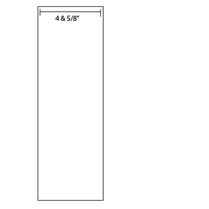

Step 1: Measure and Cut the Wood for the Platform
The body of the robot will be made of 1/8" plywood. This will be a good mixture of sturdy, light, and easy to work with. Make two octagons for the top and bottom, and 8 rectangles for the sides.

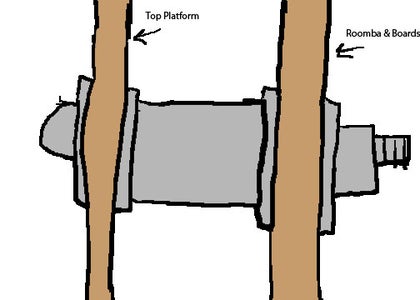

Step 7: Attach Platform to Roomba
The first two pictures will show what the assembly looks like that I use to attach the top platform to the Roomba. I use a spacer to lift the platform slightly off the Roomba, keeping it from accidentally pressing buttons. Attach the platform side first. Then slide the Roomba down into the screws sticking up and fasten.
