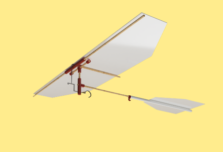

In this project, we’ll construct a rubber band-powered ornithopter—a flying device that flaps its wings like a bird. The design is based on a modular system using skewers, wires, paper, and 3D-printed parts. This project combines engineering, aerodynamics, and creativity, making it a fun and educational hands-on experience.
I created the design using Fusion 360 and chose a modular approach so that you can easily swap out parts and make adjustments to optimize flight performance. This guide will walk you through everything you need to build and optimize your ornithopter.

Step 1:
Step 1: Designing & 3D Printing the Parts
Design Overview:
I used Fusion 360 to create a modular set of parts that allows easy adjustments. By using skewers for the frame and 3D-printed parts for connectors, you can swap out components without needing to reprint everything if adjustments are necessary.
Printing Instructions:
- Download the provided STL file (attached at the end of this guide).
- Print the parts using a standard 3D printer. PLA or ABS filament works well.
- Once printed, carefully clean up any support material using pliers or a knife.

Tips:
- Test the flexibility of the wires before final assembly. The crank wire needs to be strong, while the hinge wires should be lightweight.
Step 4:
Step 4: Creating the Wings
Cutting the Wings:
- Start with a rectangular piece of regular printer paper (8.5” x 11”).
- Cut two wing shapes from the paper. The initial design can be rectangular, but feel free to trim the corners to a rounded or tapered shape for better aerodynamics.
- Folding the Wings:
- Fold a small edge along the front of each wing (about 1/4 inch) to create a leading edge. This improves airflow and lift.
- Attaching the Wings:
- Using hot glue or super glue, attach the wings to the skewers. Ensure that both wings are symmetrical for balanced flight.
- Adjust the wing angles slightly upward for better lift.
