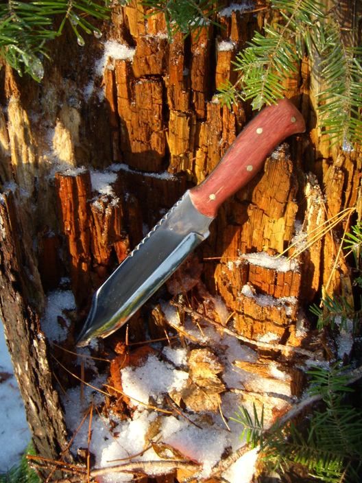

Step number one: same as last time. Get out a pad of paper and a pencil. First, the sheath has to accommodate your knife's blade. Trace out the entire knife, handle and all, on the paper--see picture one. After that's done, draw your sheath around the knife. ALWAYS allow adequate space around the blade for expansion when the knife is in the sheath and connection of the sheath's sides. Here I'm going to make a layered leather type of sheath, a good kind for beginners as leather is more forgiving than other types of material like wood or metal. My project has three layers--the back of the sheath, the front panel, and a spacer between them. I gave about a quarter inch of space (maybe a little more in places) to connect them all. Of course, this much space might not be needed if you're doing another kind of sheath, such as a buckskin or front-sewn sheath.

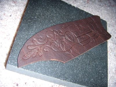

This next part you don't have to do if you don't want to or don't feel comfortable doing. I have some of the tools and some of the practice, so I'll show you how to press an attractive design into the leather.
Tooling is one of my favorite things to do on sheaths. I have a machete sheath that I've done over completely. Now, many of you professional leather workers out there might look at my handiwork and scoff, but keep in mind that I'm basically an amateur at this. I'm showing how I did it, nothing else. If you have the skill, by all means, do your best. I'm just doing mine.
So--you have a nice front panel, looks great as just plain leather and everything, but you want something more. Something to say (insert your name here) has been here and conquered. What says that more than a pretty design? Exactly. A pretty design with the first letter of your name in it. B for Basta. Get out your tooling kit.
Okay, to do this you'll need a hard surface (stone works best, but if you don't have that, thick glass or wood will work too. Just don't use your nice coffee table, as the tools can damage it even through the leather. You'll also need a pencil (for plotting out the design) and a leather tool or set of tools. This can be as simple as a nail or as complex as motorized leather stippler. If they exist. I'm pretty sure they do.
First, soak your leather, as I'm doing in picture two. This makes it supple and allows it to hold a design. Let it sit in hot water for about fifteen minutes, and when that time is over, pad it dry. Hopefully by now you've chosen a design; I got mine from this site: http://www.sentex.net/~pql/Dingbats/inits.html. Transfer the design lightly to the leather with the pencil. It shouldn't leave a pencil mark--rather, it will leave a thin impression on the leather. Try no to make a mistake. If you do, though, rub and fold the area in question until the line disappears or becomes less. Once you have your design down you can start to tool the leather. For a deep impression, press the surface of the tool into the leather without moving it. For a medium depth impression, draw the tool along the surface while applying downward pressure. This way, it's easy to draw lines and fancy filigree like I did. I also stipples the inside of my letter design--this is where you just make dots using the tip of the tool. See picture four for drawing and five for stippling. A video would surely make both of these better, but I think you get the idea. Picture six shows the leather after tooling. Let it dry out before you move on to the next step.
