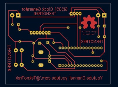

Step 1: Circuit Design
Start by designing the circuit schematic. The Si5351 module connects to the Arduino Nano via I2C (SDA and SCL lines). A 128x64 OLED display is used to display the generated frequency. A rotary encoder allows frequency adjustment, and a single resistor and capacitor ensure clean signal output.
Refer to the circuit schematic provided
Step 2: PCB Design
Using a PCB design tool like KiCad or EasyEDA, create the PCB layout based on the circuit schematic. Ensure that:
  1. The traces are appropriately routed to avoid interference.
  2. The components fit well on the board.
  3. Ground and power planes are properly connected.
Once the design is ready, export the Gerber files and send them to a PCB fabrication service. For DIY enthusiasts, you can also etch the PCB at home.

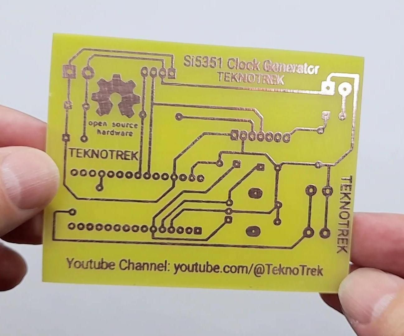

Step 3: PCB Assembly
After receiving or fabricating the PCB, solder the components onto the board:
  1. Start with smaller components like resistors and capacitors.
  2. Move to larger components like the Si5351 module, Arduino Nano, and OLED display.
  3. Solder the rotary encoder and connectors last.
For a visual guide, refer to the PCB assembly video:
