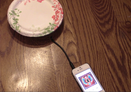

Step 8: Testing Your Speaker
To test your speaker, plug the audio jack into music player (iPhone, iPod, mp3, computer, etc.) and listen to your awesome homemade speaker!
