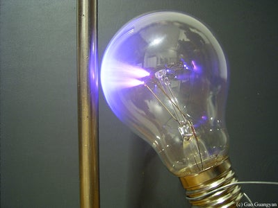

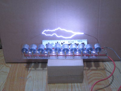

Step 6: Some High Voltage Projects
You can build -
1. Jacob's Ladder
2. Spark Gap Tesla Coil
3. Marx Generator
4. Plasma Globe
5. Ionocraft
Or just use it destroy things, like I do !!!
