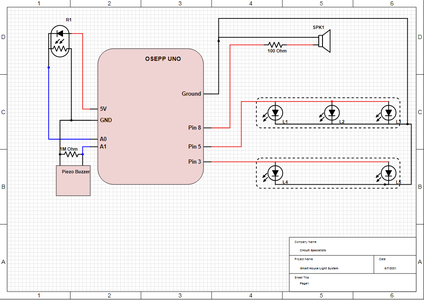

Step 3: Assemble and Testing the Light Sensor
  1. I would test the resistor value to make sure that you have the correct 10K Ohm.
  2. Assembling the Light Sensor circuit to make sure everything works. I will include the schematic below for reference.
  3. Upload the code to make sure the Light Sensor works as expected. I will attach a link below where you can download the example file. http://osepp.com/files/osepp_201K.zip
Now, we need to make the sensor portable so that it works with our Smart House project.
  1. Solder the one side of the resistor to the photoresistor as in the photo below, then solder the wire according to the code.
  2. The Light Sensor should look like the picture below.
  3. Pick a location toward the roof of the house for the best light input and connect the wire to the Arduino just like the previous step.
  4. Now we will change the code so that in a certain light condition, the LED light system for our smart house will turn on or off accordingly.

Step 6: Sound Circuit
  1. The sound circuit is fairly simple to assemble, the resistor connects to the speaker in series.
  2. Plug the circuit into an Uno to make sure everything works. OSEPP provided the sound example code in this link http://osepp.com/files/osepp_201K.zip
  3. Now, we will try to build the same circuit with a slightly bigger speaker for our house.
  4. Finally, you can protect the resistor by covering it with a T3 heat shrink tube and then set it aside.
Step 7: Knock Sensor Circuit
  1. This circuit is also fairly simple to build and test out before installing in the house.
  2. I usually upload the provided code from OSEPP to make sure the system works before moving on to the next step.
  3. Now we need to build the sound sensor so that it can go into the smart house project. The resistor is connected parallel to the Piezo Buzzer.
  4. Fold the wires down so the heat shrink tube can go over it. The final product should look like the photo below.
  5. Next, install the Sound system and the Knock Sensor to the house. Give yourself a pat on the back because the hard part is done. I will attach the schematic below for your reference or page 55 on the OSEPP handbook.

void LightSensor()
      int analogValue;
    int range;
// read our photocell
analogValue = analogRead(photocellPin);
// map the sensor range to a range of four options
range = map(analogValue, sensorMin, sensorMax, 0, 3);
// do something different depending on the
// range value
switch (range)
    // Dark turn on the light
    case 0:
        Serial.println("dark");
        LightControl(5);
//        digitalWrite(First_Floor_LED, HIGH);
//        digitalWrite(Second_Floor_LED, HIGH);
        break;
    // Dim turn on the light
    case 1:
        Serial.println("dim");
        LightControl(5);
        break;
    // Medium turn off the ligh
    case 2:
        Serial.println("medium");
        LightControl(0);
//        digitalWrite(First_Floor_LED, LOW);
//        digitalWrite(Second_Floor_LED, LOW);
        break;
    // Bright Turn off the ligh
    case 3:
        Serial.println("bright");
        LightControl(0);
        break;
// wait 0.25s before reading the photocell again
delay(25);
void LightControl(int LightLevel)
  int Light = map(LightLevel,0,5,0,250);
    analogWrite(First_Floor_LED, Light);
    analogWrite(Second_Floor_LED,Light);
