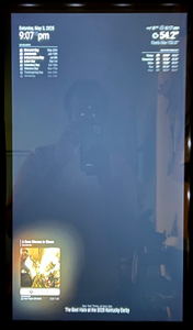

Now that your Raspberry Pi is running MagicMirror2, it's time to create the actual “mirror” part of your smart mirror. The key idea is to place a monitor behind a piece of two-way glass or acrylic. When the monitor is on, the white or bright text from MagicMirror modules will shine through the glass, appearing to float on the mirror's surface. When the monitor is off, it looks like an ordinary mirror.
1. Select the Monitor
You’ll need an old computer monitor, preferably 21–24 inches. Choose one with a flat screen and a thin bezel. Remove the plastic casing to reduce bulk and make it easier to fit into a custom frame. Be careful during disassembly—monitors contain delicate electronics and capacitors that may hold a charge.
2. Choose a Two-Way Mirror
You’ll need a two-way mirror, also known as a one-way mirror or “see-through mirror.” There are two good options:
  1. Acrylic two-way mirror: Lightweight and shatterproof, ideal for wall-mounted builds.
  2. Glass two-way mirror: More reflective and durable, but heavier and more fragile.
Make sure the mirror is cut to match the size of your monitor (usually slightly larger to cover the bezel edges).

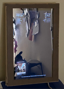

3. Build a Frame
Design or repurpose a picture frame or shadow box that can hold both the two-way mirror and the monitor securely. The frame should have enough depth to house the monitor, Raspberry Pi, cables, and other hardware. A wooden frame is easiest to work with if you plan to mount it or add components.

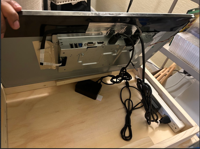

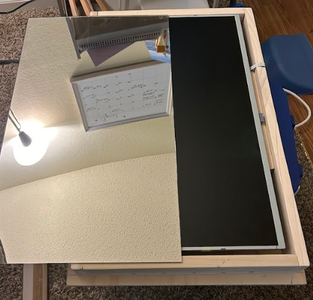

4. Assemble the Mirror Display
Start by placing the mirror in the frame with the reflective side facing out. Behind the mirror, securely mount the monitor with its screen facing the back of the mirror. You can use brackets, adhesive Velcro, or foam padding to ensure a snug fit without damaging the display. Be sure to leave ventilation gaps and access points for power and HDMI cables.
5. Mount the Raspberry Pi
Secure the Raspberry Pi to the back of the monitor or the inside of the frame using double-sided tape, screws, or a custom mount. Connect it to the monitor with an HDMI cable and power it with the USB-C adapter. If you plan to keep the setup in place, you might want to use cable ties or clips for neat cable management.
