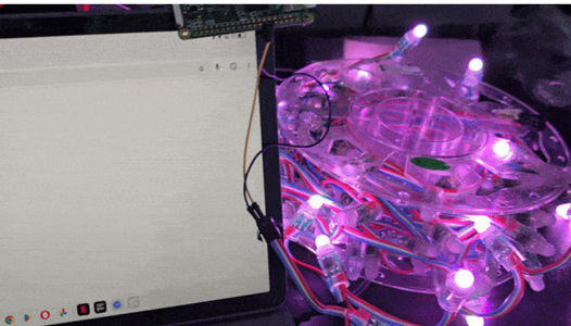

So this is a bit different. In a recent live stream, we coded an RGB strip light web control system using an old Raspberry Pi Zero W. After the stream, I received a few messages asking for a comprehensive guide on how to set it all up, so here it is, along with the demo.
Demo of lights working
Unlike most of my articles, there will be a video to go with it, so check the YouTube channel, where I will also explain how the code works.

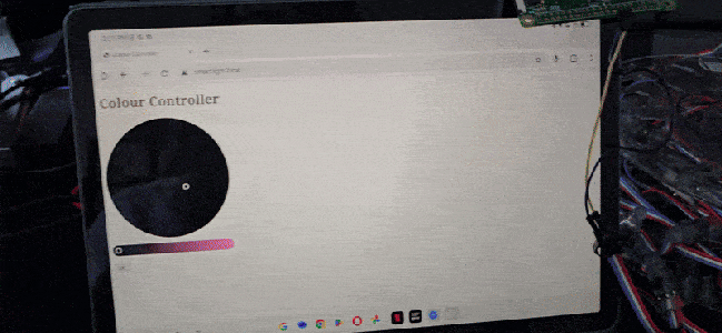

Run sudo python app.py and you should see a URL. If you did your wiring right, it will all work. If not, check your cables.
Step 5: The Final Touches
OK, so we are going to set up a systemd service to run the app on boot, as well as a hostname so we can just enter smartlight.local into our browser and the page opens, instead of us having to find the IP every day.

Run sudo raspi-config, and navigate through the menus with your keys: System Options > Hostname. The default host name is raspberrypi I changed mine to smartlight just make sure its all lowercase and has no spaces. After that you should be prompted to restart the pi. If you did't run sudo reboot
Once the Pi has turned back on you should be able to open up your firefox (fine ill let you use other browsers if you really want to) and type in http://smartlight.local/ this will be the control panel to your lights.
