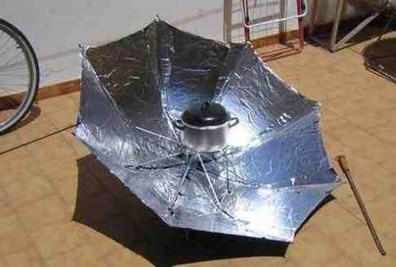

Step 2: Cover the Umbrella With Aluminum Foil
Carefully cover the entire surface of the umbrella frame with aluminum foil. Make sure to smooth out any wrinkles to ensure maximum reflection of sunlight. Use tape to secure the foil in place if needed.
Step 3: Shape the Foil Into a Parabolic Surface
Shape the aluminum foil-covered umbrella frame into a parabolic surface. This will help in concentrating sunlight onto the cooking vessel placed at the focal point. You can do this by gently bending and shaping the foil-covered frame until it resembles a parabolic dish.
Step 4: Create a Cooking Platform
Once you've shaped the foil-covered frame into a parabolic surface, create a stable platform at the focal point where you'll place your cooking vessel. Use additional layers of aluminum foil to fashion a tray or platform for your pot or pan to sit on securely.
Step 5: Adjust for Optimal Sun Exposure
Once your solar cooker is assembled, place it outdoors in an area with direct sunlight. Adjust the angle of the cooker throughout the day to ensure it's facing the sun directly for maximum efficiency. This may require occasional monitoring and adjustments.
Step 6: Cooking With Your Solar Cooker!
Now that your solar cooker is ready, you can start cooking! Place your pot or pan containing your food onto the prepared platform at the focal point of the cooker. Keep an eye on the cooking progress and adjust the cooker's position as needed to maintain optimal sunlight exposure.
