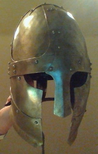

Step 2: Step #1: Patterning Your Helmet.
Ok, So the first thing you need to do is Draw your helmet. Get a good idea of what you want the finished project to look like. If you cant put it down on paper you'll probably have a hard time making it with steel.
Got a few pictures of what you want? Good. Now it's time to start actually making patterns for this.
First thing you need to do is get the brow band. A good rule of thumb for this is to take the circumference of your head and add 3" for 1/2" of padding, or 5.5" for 3/4" of padding. Alternately you could add whatever padding you want to your head then measure the circumference.
In any case, The brow band for this helm is 1 1/4" wide and about 28" long.
Next come the bands. For a basic spangen helm you can just cut a pair of rectangle bands, 1-2" wide by however long you need and make them cross over the top, dividing your helmet bowl into 4 quarters. it's pretty simple. But, since I wanted something a little fancier here is how I did it.
I took the length of my brow band, divided it by the number of bands i wanted to use (5) then rounded that to the nearest half inch to keep things simple. That gave me 5.5" as a base line. Next I chose 6" as a length for my bands. I just pulled 6" out of the air and got lucky. often times patterning takes a few tries to get it right. From there I added another 1 1/2" to the base and drew in one half of the profile I wanted. Next i cut out that half, folded it over, traced it and cut out the other half. Now trace that out 4 more times and cut them all out.
For the disc that holds them together on the top I just traced the lid off a jam jar that looked to be the right size. It was very complicated scientific process
Now tape them all into place on your brow band to get an idea how they fit. they will likely need to be tweaked, you may even have to go through a few sets before you get it right.
Congratulations, that's the top of you helm. Once your happy with it it's time to move onto the cheek plates and the nasal. I'm afraid that there really isn't much in the way of measurements for these. Look at pictures online, look at your drawings and just start cutting out pieces until get something you're happy with. Don't be afraid to look like an idiot in a cardboard hat and try it on to make sure you can move your head, and that nothing is in the way of your eyes.
I opted to put a slat back on this helmet instead of the skirt plate that I had in my drawings, again, just like the cheek plates and nasal they are something you just have to eyeball. It seems i didn't take any pics of them getting patterned, but they're pretty simple. make a rectangle about 1"x5" and your pretty much there. if it wont be hidden maybe ad a bit of pizazz to make them look nice, and just make sure they aren't so long that you cant move your head properly.

Step 5: Building the Frame Pt. 2 the Top Plate
The top plate has a couple of steps that the bands don't. First, give it a quick once over in the shallow dish, that gets the steel to start moving and makes the next steps easier. Once it's been shallow dished move it over to the deep dish and give it a few more passes. You can stop here, but I figured I'd give mine a little something extra and add a little boss to the center. To do that I cleaned up the edges of an appropriately sized hole in a hunk of steel (actually the base of my T stake) then centered the top plate over it. Next I placed the ball end of my riveting hammer in the center of the top plate and gave it a few good smacks with the shallow side of my dishing hammer. You should be left with something that looks like a tiny UFO.
Now place it on top of your bands and check how it fits. Odds are it wont. Thankfully you should still be able to bend and twist your bands as needed to make it fit. Something else that will really help is to bend the tips of the bands up with a pair of pliers so they fit into the top plate rather than under. Once your happy with your fit mark punch and drill your holes, then bolt it all together.

Step 7: The Panels
Now that the frame is together it's time to pattern out the panels. Patterning out the panels is dead simple, just lay the frame on some patterning material (in this case old cereal boxes) and trace out each of the openings. After you trace out each opening add 1/2" to 3/4" of rivet allowance. You also want to make sure to mark which panel is which, and that the marked side will be the side that faces inside the helmet. tThis is because odds are the panels wont be perfectly symmetrical, and they may not fit properly in any of the other spaces.
Once you have your patterns transfer them onto your steel, cut them out, finish the edges then give them a couple passes in the shallow dish.
After I had them dished I marked, punched and drilled my rivet holes in the band. 14 for each panel. It's a little overkill, but it looks sweet.
After you've put the holes in your bands it's time to fir the panels. If your lucky they'll just slip right in. I was lucky for a few, but a couple of them needed some serious man handling.
I started with the back panel. Lucky for me it fit right in place without any tweaking, so I held it in place, marked a few of the rivet holes then punched and drilled them. Once they were drilled I used clecos to hold it in place and used the remaining holes in the bands as my guides to drill the rest of the holes.
The second panel didn't fit so well. It needed some more curvature added to it. To add that extra curve i just used the jaws of the vice and a little muscle to tweak the curve into place. Bending it with the vise let me get it pretty close to fitting right, but the top corner was still out of whack. So i drilled the holes for the side that fit right, then put clecos in each hole to hold it in place. Next I put it over the ball stake and used a rubber mallet to try and knock it into alignment. That got me about half way to where I needed it to be, so I finished it by reaching through with my dishing hammer and bashing the panel the rest of the way into place from the inside. once I was happy with the fit I drilled the rest of the holes and moved on.
The last 3 panels all went in pretty easily. 2 of them needed some light tweaking with the hammer, but nothing major.
Once they were all fit I planished them and then it was time to move onto the cheek plates and the slat back.

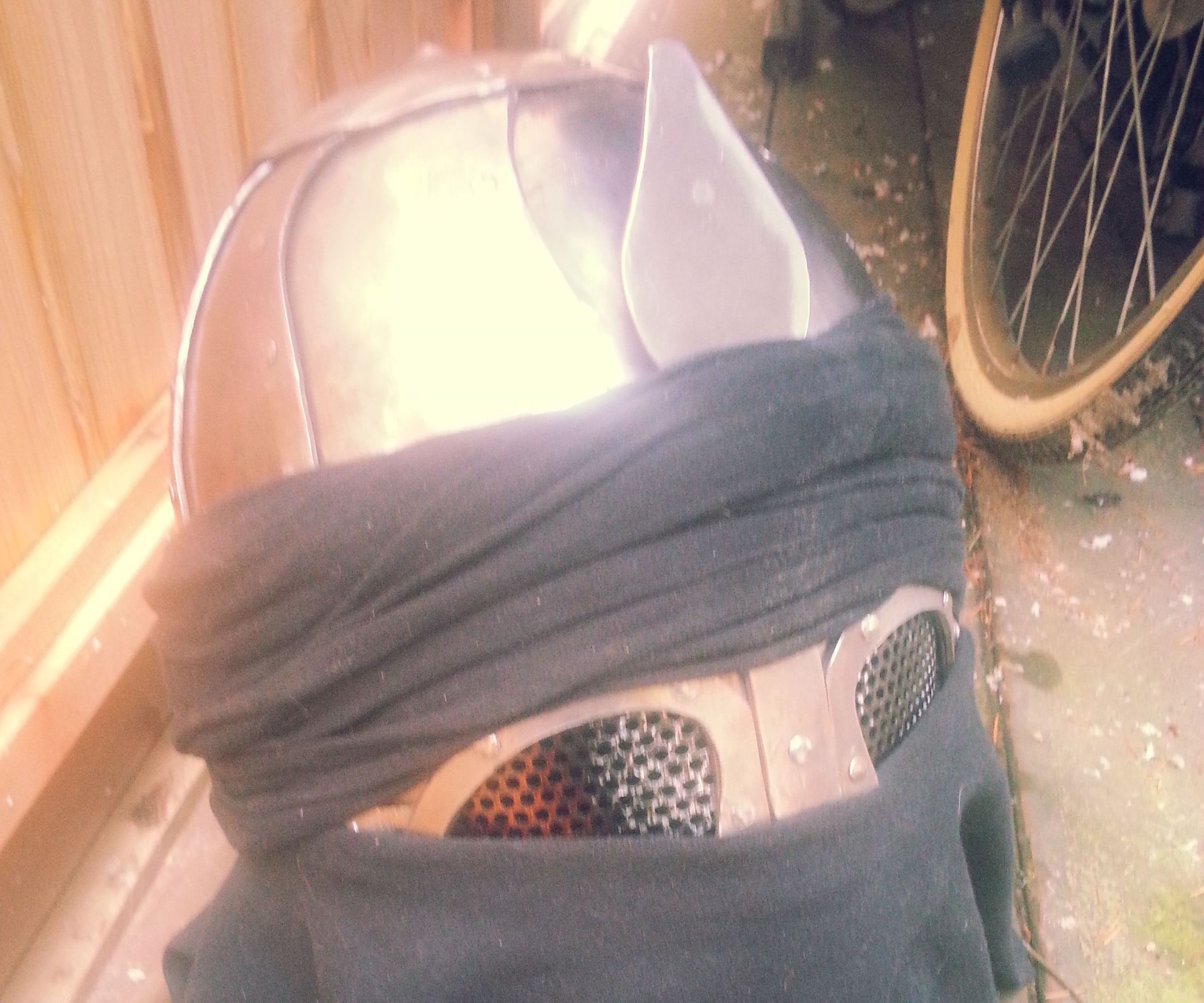

Lastly We'll do the nasal. I started by creasing the nasal. To do that I marked my center line as far up as i wanted the crease to go, then clamped it into the vice and hammed it over a little. It's that simple. Next I dished top portion of the nasal a little in the shallow dish, that makes it sit nicely against the top of the helm.
Once i was happy with the fit I marked the existing holes in the brow band on it, drilled them, then while the nasal was held in place with clecos I marked and drilled the other rivet holes.
That's it, all that's left to do at this point is your finishing and assembly.
Step 9: Finishing and Final Assembly
Now that your helmet is all shaped and has all the rivet holes all that's left to do is your finishing. Whether you paint, powder coat, blacken, blue, russet, polish or whatever else is up to you. Myself, I take advantage of an industrial tumbler to burnish my plates.
Once you've done whatever finishing you choose it's time for the final assembly.
Start with the dome and cleco or bolt in a panel, then go over it and one at a time remove each fastener and replace it with a rivet. Start with the back panel and work your way to the front just like you did to make all the holes in the first place.
Next put on the cheek plates, then the slats. Last comes the nasal. If your adding a bar grill or something similar then obviously that should go on before the nasal.
