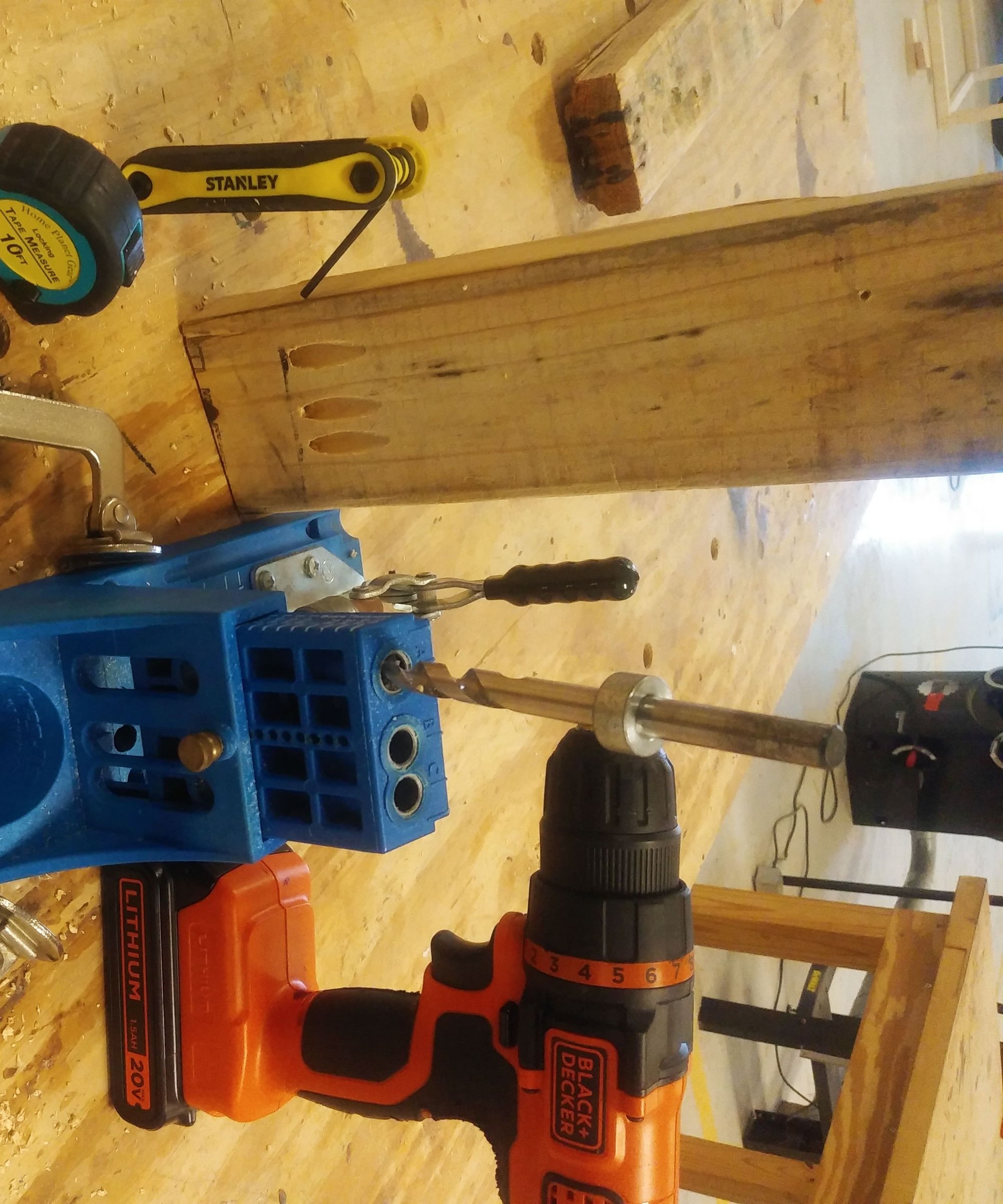

Step 5: Adding Pocket Holes
After making sure everything has been cut and proportioned the next step is to make the pocket holes which help attach the legs to the seat while maintaining a clean look. I only added two to each leg for the seat due to 2 being enough for the security.
