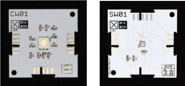

The ESP8266 Core and Wi-Fi module (xChip CW01) allows users to send data from XinaBox’s modular xChips to the cloud. This data can be monitored remotely in Ubidots, where users can take advantage of their range of IoT tools.
The xChip SW01 Advanced Weather Sensor (Bosch BME280) measures temperature, humidity and atmospheric pressure, from which altitude, cloud base and dew point can also be calculated.

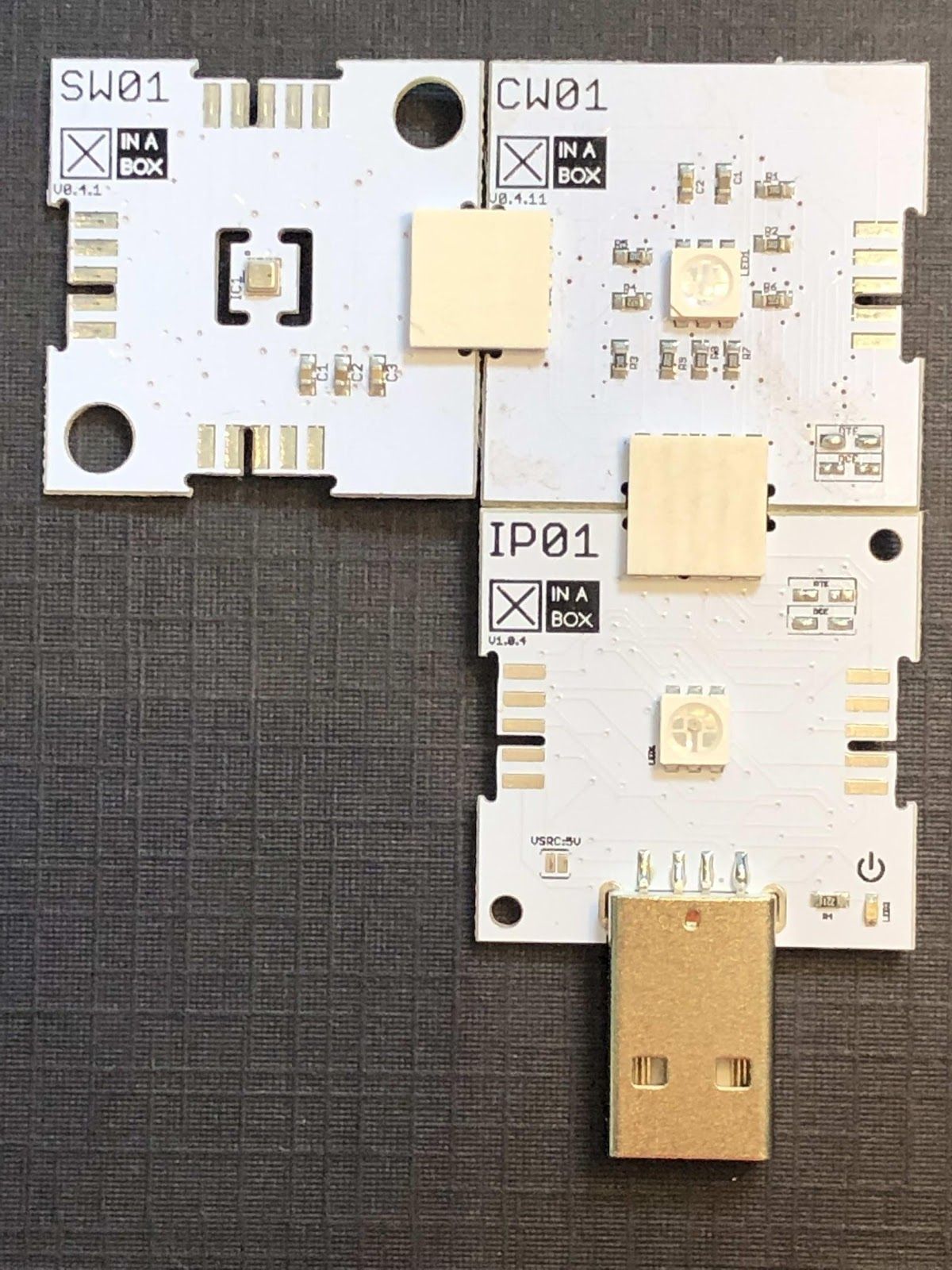

Connect CW01, SW01 and IP01 together using the XC10 xBUS connectors. You may connect it as shown in the diagram below. Please see this guide on how to assemble xChips generally.
Then, connect your device and PC through the IP01’s USB. For this, you will need to use the xFlasher software to flash the code once ready. See this guide on using the xFlasher.

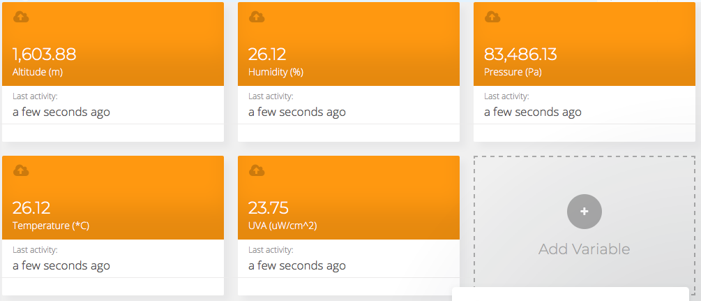

1. Open your Ubidots account. You will see a device named “ESP8266” with 4 variables (see image below).
- Device visualization
- Variables visualization

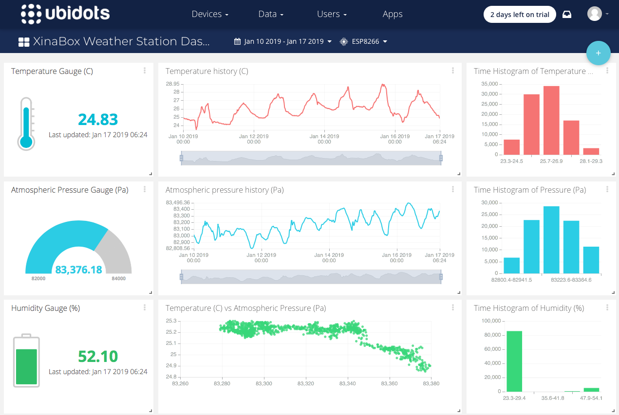

Dashboards (static and dynamic) are user interfaces to organize and present a device's data and the insights derived from the data. Dashboards contain widgets that display the data as charts, indicators, controls, tables, graphs, and other size, shapes, and forms.
To create a new Dashboard in your Ubidots account, refer to the following Ubidots tutorial to learn how to do it.
Just as a reference, once your Ubidots Dashboard is created you should have something similar to the image below:

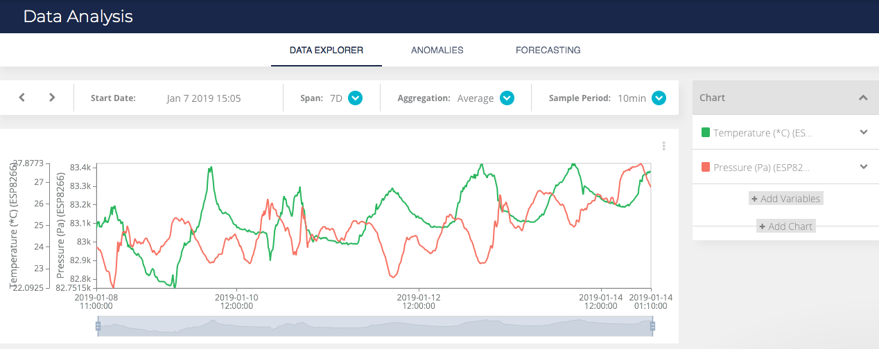

PRO TIP: There are also a range of graphing and reporting tools. If you want to learn more about this, we recommend you check this guide.
