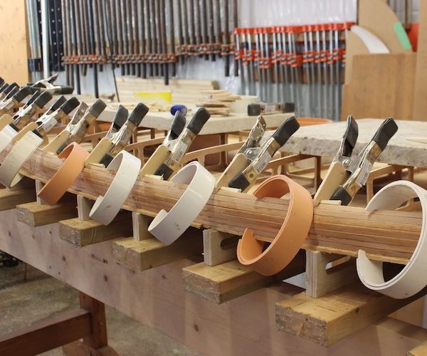

Step 4: Bead & Cove Rails
The SUP's rails are built by stacking 1/4" x 3/8" bead & cove strips one at a time. These narrow bead & cove strips have many benefits over boards built with solid rails. The first is the individual narrow strips are easy to bend and usually the only the first few require any steaming. A cloths iron provides enough steam in about 1 minute and laminating many narrow strips is both easier and more stable than forcing a single piece into position. Since the boards shape is defined by the internal fishbone frame DIY builders do not have to know how to properly shape the boards rails to achieve the correct shape. The outer skins thickness is never thicker than 1/4" thick resulting in a board that ends up weighing only 10 percent heavier than a quality foam board.
