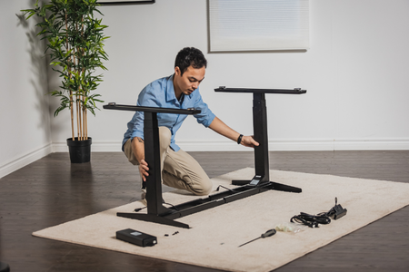

Step 2: Assembling the Desk Frame
Once you are familiar with the specifications and found them suitable, start with assembling the desk frame by using our Solo Ryzer Frame User Manual for reference on the full step-by-step assembly procedure. Assembling the unit should take 20 minutes or less. Once it’s assembled, make sure to test the remote control by raising and lowering the motorized table lift with the UP and DOWN buttons. We also have our assembly tutorial video for reference below:

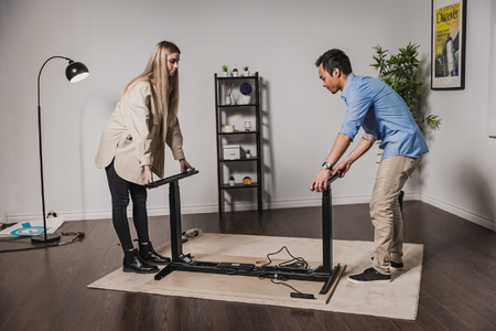

Step 3: Placing the Frame and Tabletop Together
With the motorized desk lift assembled, you’ll now want to flip it over and place it on the underside of your chosen tabletop. We recommend having at least two people to flip the two-legged desk lift mechanism set as it is quite heavy.

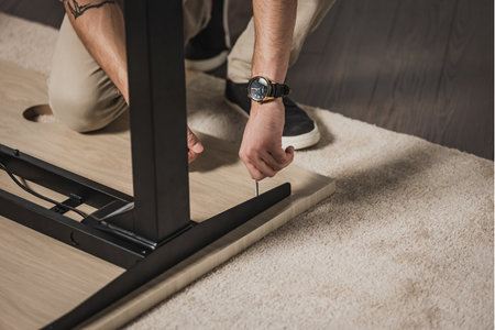

Step 4: Positioning and Securing the Tabletop
Once the frame is on the chosen tabletop, adjust the width of the table lift to fit your tabletop using the crossbar center rails. If you have a Progressive Desk tabletop, use the M6x13 Machine Screws included in the tabletop packaging. Line up the desk frame with the predrilled holes on the underside of the tabletop and insert all machine screws before using the Allen wrench to tighten each of them.
If you have your own tabletop, position the desk frame so that the tabletop extends 1.5" beyond the side brackets. Next, use a screwdriver or power drill to install the 7 included pieces of S5x20 Wood Screws into the hole positions.

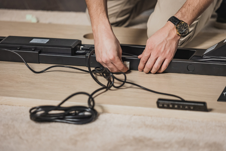

Step 5: Mounting the Remote and Control Box
Now it’s to time to secure the control box and hand remote to the underside of the desktop. Slide the control box into the frame end CB as seen in the user manual. You may then place the remote wherever you prefer and install it on the tabletop using a screwdriver or power drill and two S5x16 Wood Screws. Next, use the included cable clips to secure the wires so they are hidden from view and aren’t hanging loose from the desktop once the standing desk mechanism is flipped over.

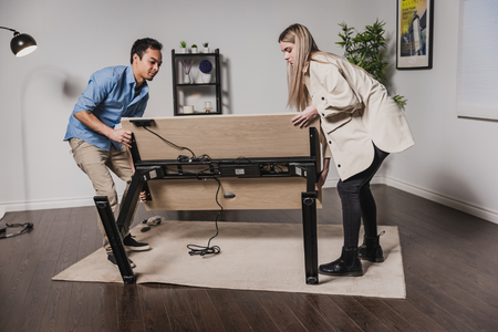

Step 6: Flipping the Desk Into Position
With everything secured and ready to go, you can flip the fully assembled desk lift kit over. We recommend having at least two people for this. Before it’s ready for use you must reset the table lift mechanism. To do this just hold the DOWN button on the remote until the lift reaches its lowest point (slightly rises then stops). Once this happens, release the DOWN button and your standing computer desk is ready for use.

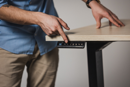

Step 7: Program Your Preset Positions
Depending on the remote you choose, the Solo Ryzer Frame also features the ability to program preset positions so the lift will automatically move to your own custom positions with the press of a button. All you have to do is find your desired height and press the “M” button followed by a number 1-4. With that, your preset position is saved to whatever number you chose.
