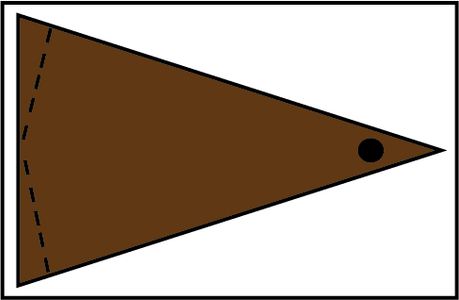

Step 10: Assemble the Pouch
Materials for this step:
  1. 3" leather square
  2. Heavy-duty thread
  3. Both lengths of mason twine
Tools for this step:
  1. Awl
  2. Pencil
  3. Heavy-duty scissors
  4. Sewing needle
Assembly:
  1. This step requires some calculations. First off, find the diameter of your projectile. If it's not round (like a small rock), then estimate. My projectile is a 1/4" marble, so this wasn't difficult for me. The pouch should be a rhombus 1.75 times your diameter tall and 4.15 times your diameter wide. For me, that means that my pouch should be 0.4375" tall and 1.0375" wide. Mark these dimensions off on your piece of leather.
  2. After finding your ideal dimensions, cut a rhombus (diamond) shape of the appropriate dimensions out of the leather using the heavy-duty scissors.
  3. Fold the diamond shape in half. Using the awl, press holes through it as shown in the diagram above (these holes are represented by small lines, which are for illustrative purposes only-- more holes than that should be made). Stitch through these holes using the large-eyed sewing needle and the heavy-duty thread, making sure that it is stitched and tied off securely on both sides.
  4. Use the awl to place large holes in each corner of the pouch, as shown in the diagram above. Then, tie one piece of mason twine to each side, making sure that you don't use more than 1.5" of either end to tie the knot.
  5. Tie the other two ends around the eye bolt on the arm. Your trebuchet is completed!
