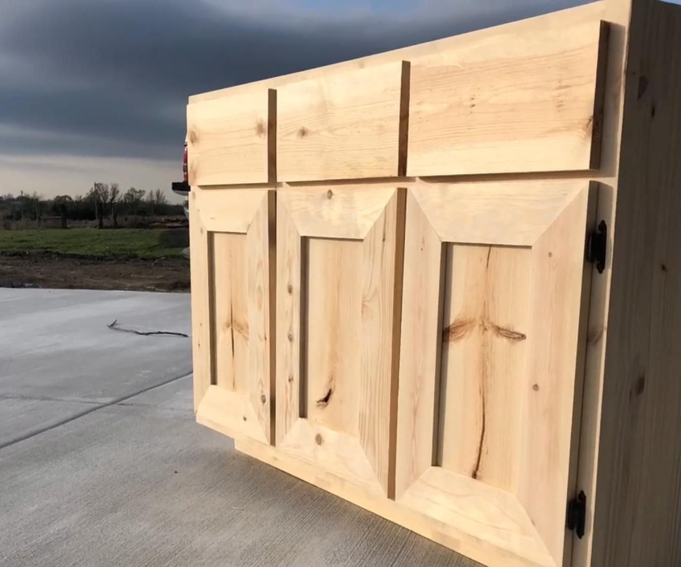

Step 10: Cut Two 1x12s to 14 Inches Long
These will be the cabinet doors on the bench.
Step 11: Cut Four Pieces of Lattice 14 Inches Long
These will make the stiles of your cabinet doors.
Attach these to the front of your cabinet doors with wood glue and finish nails.
They should be flush with the sides.
Step 12: Cut 4 More Pieces to Fit
Measure between the side pieces and cut four pieces of lattice to fit on the top and bottom edges of the cabinet doors.
My pieces needed to be 8 3/8" long.
Attach these to the top and bottom with wood glue and finish nails.
Need help? Watch the video!
