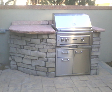

Step 3: Steel Frame and Cement Board Construction
This is the most traditional way to build an outdoor kitchen. In a nutshell: first a frame is welded from 304 stainless steel or aluminium studs. You can also join them by screws. Afterwards cement board with matching cutouts is applied onto the frame. The top is covered with counters (usually granite, though i did see another instructable here on the cement ones - they must be very heavy though...). All hardware is installed - grills, doors etc. And afterwards the cement board is covered with the veneer of your choice - stucco, stones, tiles, or a combination of all.
Of course of all this you will need a 4" cement footing or an otherwise solid non-sinking surface. Do not build on soft ground or even pavers - the kitchen will sink overtime and most likely break.
The board used is basically any decent cement board - Hardibacker or Durock or similar. It will be easy to cut and will readily accept any veneer.
This is a great and undisputed way to build a kitchen. However... As stainless as the studs are they are still vulnerable to rust if you are near seashore. And in general stainless steel does rust in the open air. One other problem is that a structure like this often cannot support a very high weight (unless built with extra vertical studs). Another way is to use concrete panels and build the hole thing from them.

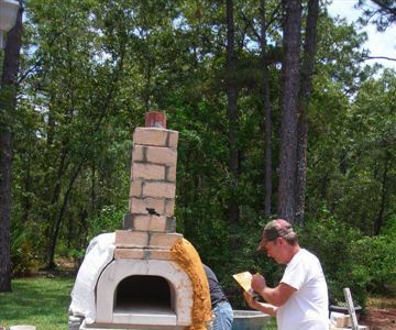

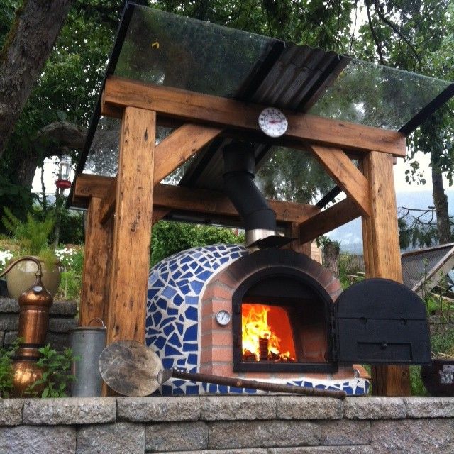

Step 6: Wood Fired Pizza Ovens.
This will require a cinder block base unless you are using the concrete panels.
