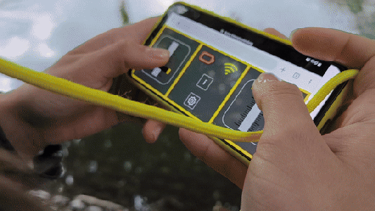

As mentioned above, our brain already has receiver features integrated. It has Wi-Fi, allowing us to communicate wirelessly with it. But we still need a device to send our commands. I like to use a smartphone for that. I built a little website as a control interface, so you don't have to. Under the hood, our Brain board will act as a server and serve the website to whatever phone we want to use to control it. After that, the little website on our phone will open a so-called "Web Socket" connection to constantly talk to the brain and send our inputs. I also spent an extensive amount of time to program failsafe features, as the Wi-Fi connection can get lost. The website will tell you that and automatically reestablish a connection when you get closer to the duck.

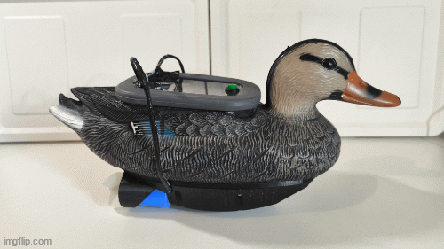

It's creepy, it feels wrong, and I don't like it, but we have to get our electronics into the duck's body. The easiest way to do that is to cut a big hole into it's body and put a box for the electronics inside. While we do that, we have to make sure to put our heavy components, such as the battery as low as possible, in order to have a more stable duck.
Put some tape on your insertion area and mark the material to be removed. Then drill one or more pilot holes and use a side cutter or a saw to cut it out. You might have to do some more chipping away on the border until the hole snugly fits around the box. Then you can glue it in place. I like to use waterproof construction glue for that.
After you are done, be sure to give the duck some rest, so it can recover from the procedure and get used to its new and improved body structure.
Step 3: Boatify the Bottom
Boatification is a new word that I just made up to describe the process of turning the bottom of the duck into a boat like shape.
For me, this involved a lot of measuring and designing. However, if you manage to get a duck, that is similar to mine (in terms of size) you can just download the attached 3D components. These have to be printed and prepared. Preparations means inserting threaded M3 inserts into the pilot holes using a soldering ion. A very satisfying process, just make sure to keep the ion at the lowest heat setting, otherwise it will be a pretty melty experience.
To attach the bottom plate, we first have to cut off the bottom weight and sand it smooth. Just be very careful not to puncture the bottom of the duck in doing so. A smooth bottom allows us to glue the bottom plate onto it.
While the glue is drying, we can assemble the motor holder by screwing it onto the baseplate and sliding the motors inside, making sure to secure them with screws and hot glue. The front bottom part of the hull also screws in using M3 screws.
That's it, the bottom is now boatified and the hull pretty much ready to go.

Now take out your phone and connect to the duck's Wi-Fi access point. It should be called "Ente" and the password is "RowYourBoat". Your phone will probably cry for help and try to go for another network, as soon as it detects the missing internet connection. Be sure to tell it that it is ok to connect to this offline network and to stay connected. Now open up a browser and go to the address 1.2.3.4. You should be greeted with a little controller website, and you should be able to use the joysticks to spin the motors. If one of them spins in the wrong direction, you might have to switch the two motor wires around.
