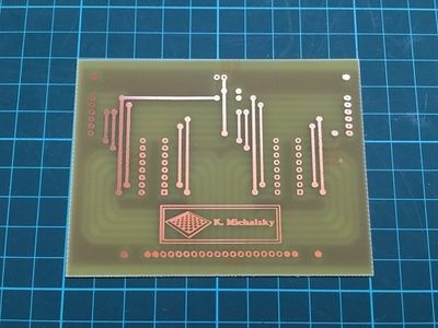

Step 2: PCB-Boards
PCB-Boards are attached as fzz-File(Fritzing) as well as pdf-File, just print them out and follow the link below to learn how etch multilayer PCB-Boards:
