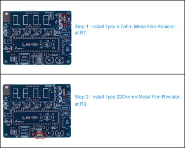

Step 1: Install 4.7ohm Metal Film Resistor & Install 220Kohm Metal Film Resistor

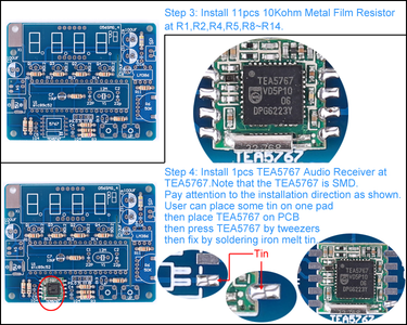

Step 2: Install 10Kohm Metal Film Resistor & Install TEA5767 Audio Receiver

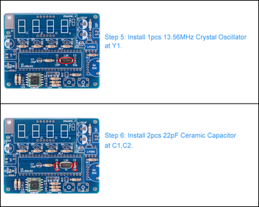

Step 3: Install 13.56MHz Crystal Oscillator & Install 22pF Ceramic Capacitor

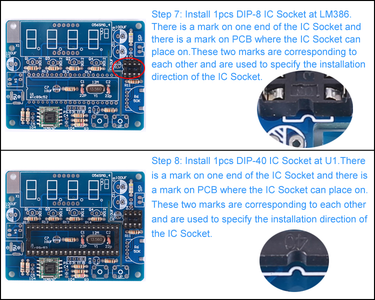

Step 4: Install DIP-8 IC Socket at LM386 & Install DIP-40 IC Socket

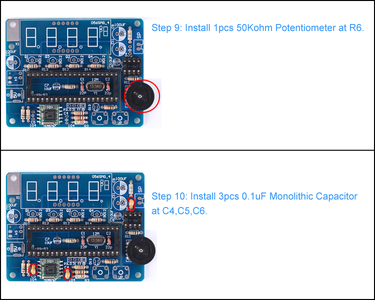

Step 5: Install 50Kohm Potentiometer & Install 0.1uF Monolithic Capacitor

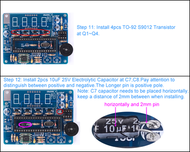

Step 6: Install TO-92 S9012 Transistor & Install 10uF 25V Electrolytic Capacitor

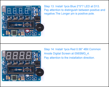

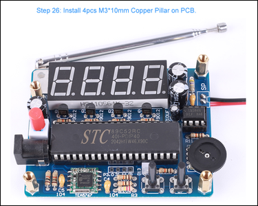

Step 7: Install Blue 2*5*7 LED & Install Red 0.56" 4Bit Common Anode Digital Screen

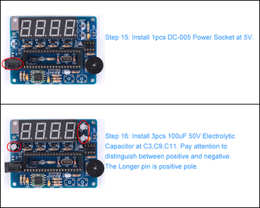

Step 8: Install DC-005 Power Socket & Install 100uF 50V Electrolytic Capacitor

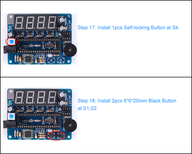

Step 9: Install Self-locking Button & Install 6*6*20mm Black Button

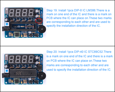

Step 10: Install DIP-8 IC LM386 & Install DIP-40 IC STC89C52

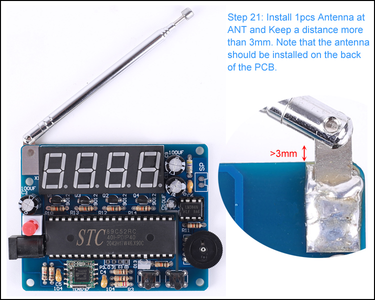

Step 11: Install 1pcs Antenna at ANT and Keep a Distance More Than 3mm

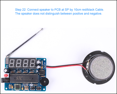

Step 12: Connect Speaker to PCB at SP by 10cm Red/black Cable

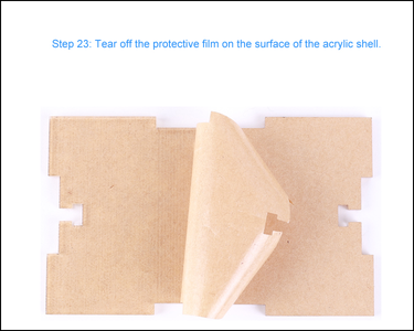

Step 13: Tear Off the Protective Film on the Surface of the Acrylic Shell

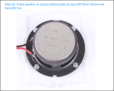

Step 14: Fixed Speaker on Acrylic Bottom Plate by 4pcs M3*8mm Screw and 4pcs M3 Nut

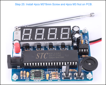

Step 15: Install 4pcs M3*8mm Screw and 4pcs M3 Nut on PCB
Step 16: Install 4pcs M3*10mm Copper Pillar on PCB

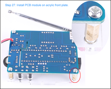

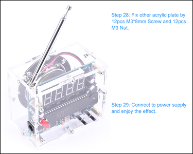

Step 17: Install PCB Module on Acrylic Front Plate
Step 18: Fix Other Acrylic Plate by 12pcs M3*8mm Screw and 12pcs M3 Nut & Connect to Power Supply and Enjoy the Effect
