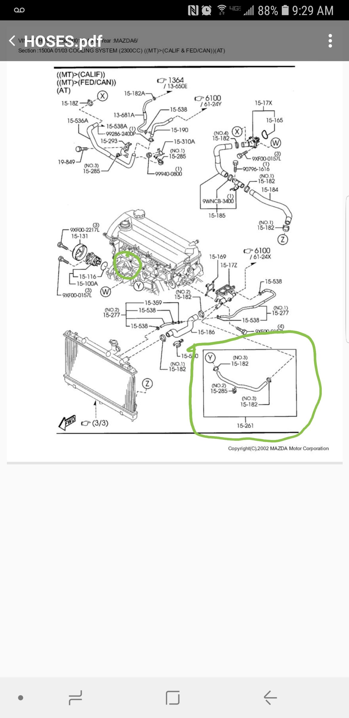

    B.K.M2
    B.K.M2
    Question 3 years ago
    here is diagram of where mechaic says is now leaking and had nothing you do with thermostat replacement. Is this true?
    0
    mfrontuto
    mfrontuto
    Answer 2 years ago
    could be. hoses, especially soft line hoses go bad, get brittle and eventually leak and need to be replaced. I looked at the pic, are those hose clamps on either side of that hose? I remember that those factory crimp style hose clamps need to be put back where they were originally put sometimes or else the hose could leak. you will see an indentation of where they were last if they are not put back in place. but unless it has been leaking for a long time or has completely become undone, and you have not checked your coolant levels in some time that should not cause the temp to go sky high. But I would still replace the hose, better safe than sorry.
