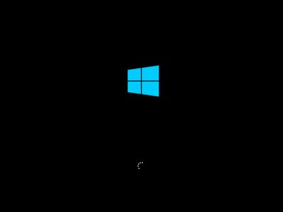

Step 3: Part 3: Booting and Installing Windows
Place the hard drive back into the target machine. Make sure that the BIOS is configured to boot from the hard drive. If you did everything correctly, you should see the blue Windows logo (see picture for example) and setup will load (really fast, too, because it's loading from the hard drive). Install Windows as usual (but don’t format your drive this time in the installer – otherwise it will erase the Windows 8 setup files too!).
