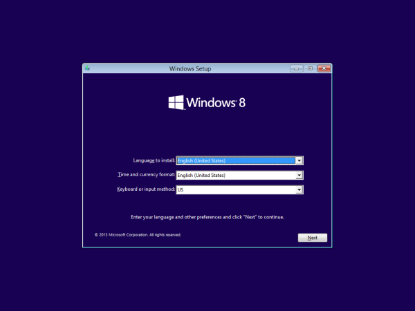

Step 3: Booting and Installing Windows
Place the hard drive back into the target machine. Make sure that the BIOS is configured to boot from the hard drive. If you did everything correctly, you should see “Windows is loading files” screen and setup will load (really fast, too, because it's loading from the hard drive).
This step is extremely important. If you skip this step, you will get the “A required CD/DVD drive device driver is missing” error.
When you see the “Windows is loading files” screen, hold the left CTRL button. This will force a repair command prompt console. (See picture for example) When this comes up, type the following:
del C:\boot\bcd
bcdedit /createstore
C:\sources\setup
Install Windows as usual (but don’t format your drive this time in the installer – otherwise it will erase the Windows Vista setup files too!).
