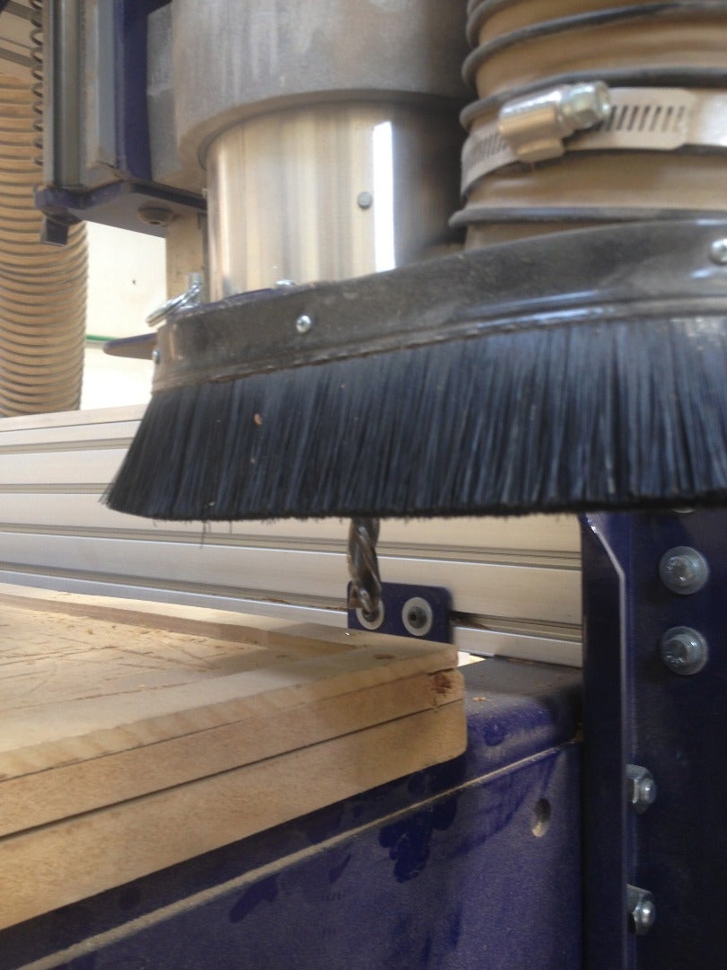

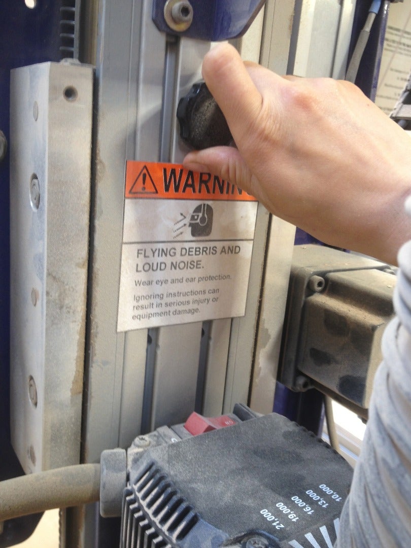

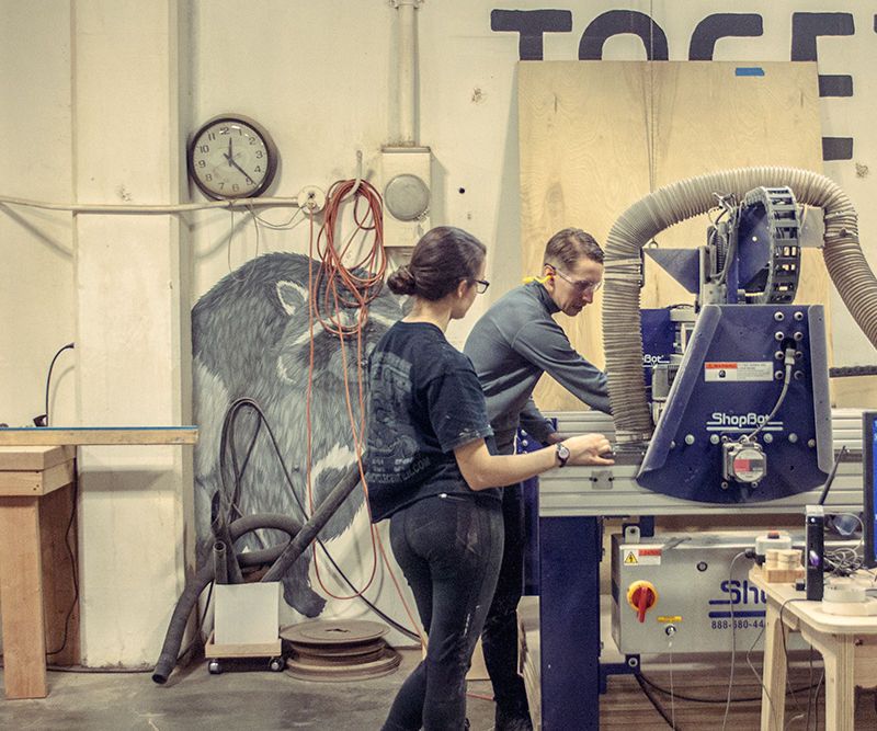

Step 5: Install Bit
6. Installing Bit
-Turn on Shop Bot
-Open ShopBot 3-Make sure the router bit is safely above the table (Can use MZ to adjust height ex. MZ 3 sets the router to a Z height of 3 inches above the table)
-Move the router into the table, I prefer calling M2 10, 10 but you can also use the toggles in the yellow control panel

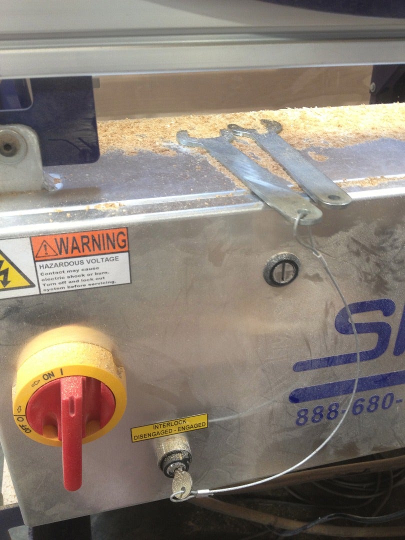

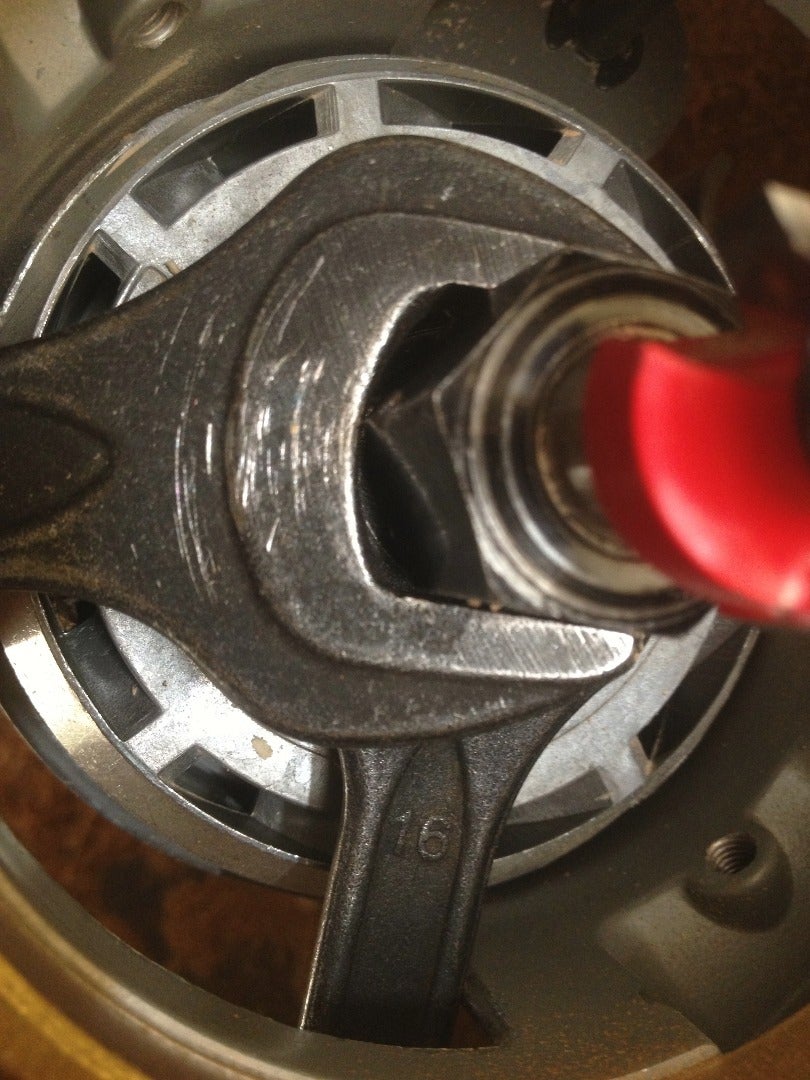

-Unlock the Interlock Wrench and grab its counterpart
-Loosen the vacuum hose brush
-Loosen the collet using the two wrenches as shown
-Change bit or hand tighten a new collet with a bit needing a different shaft size
-Tighten collet as shown
-Retighten the vacuum hose brush
-Choose the speed for your router based on what bit you’re using

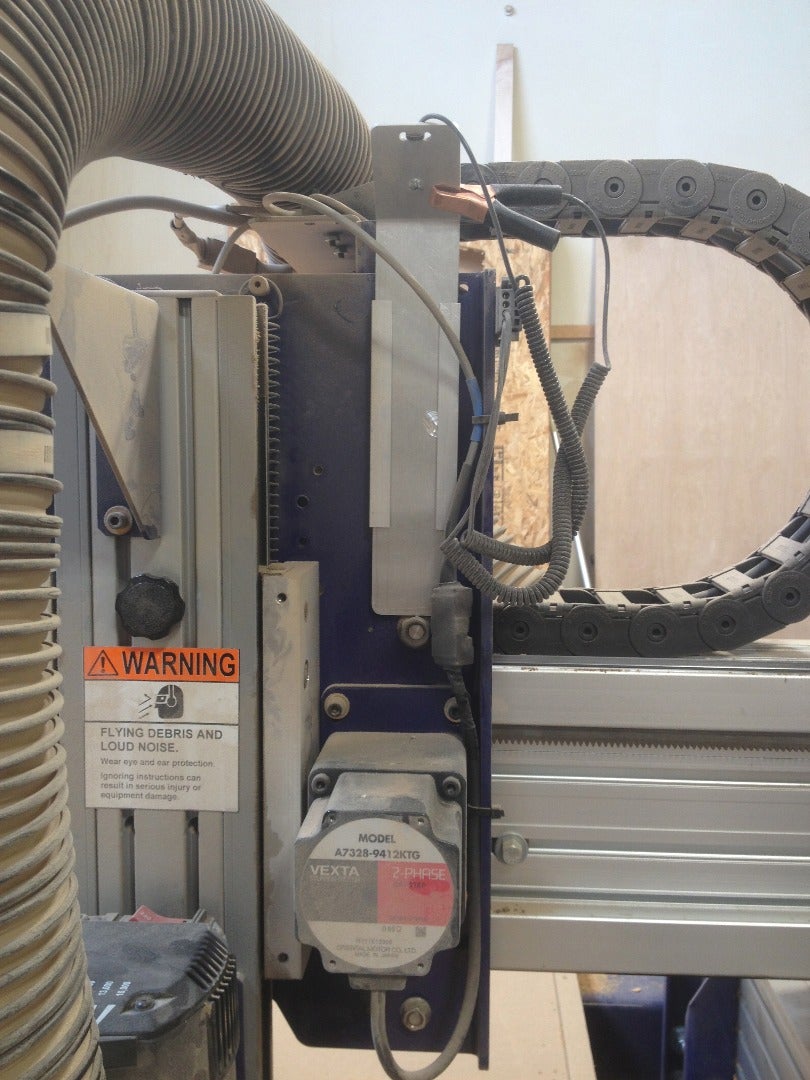

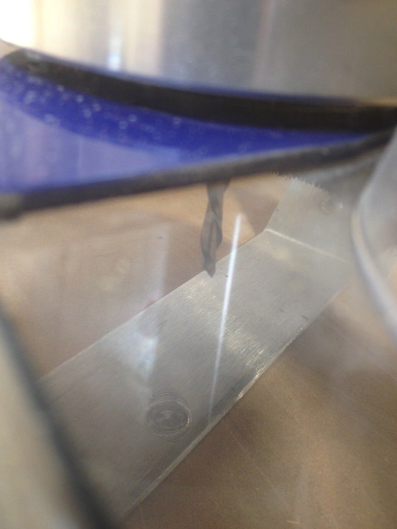

Step 6: Zero the Z Axis
7. Zero the Z Axis
-Pull the Zeroing Plate and Alligator Clip off of the router
-Attach the Alligator Clip to the Zeroing Screw on the CNC Router
-Place the Zeroing Plate with a direct vertical path below the router bit
-Call C2 on the control panel in Shopbot 3
-A pop-up will appear in ShopBot 3 that asks you to make sure that the Alligator Clip and Plate are in position. You will need to agree to this for the zeroing process to begin.
-Watch the Zeroing process to ensure the bit will hit the plate
-Another pop-up will appear on the screen asking you to return the Alligator Clip and Plate.
-The router should stay at a safe height above the table after being zeroed, however, if need be, raise the router safely above the table (ex. MZ2 or use the toggle control panel)-Call MH in Shopbot 3 to return the router to the X and Y home

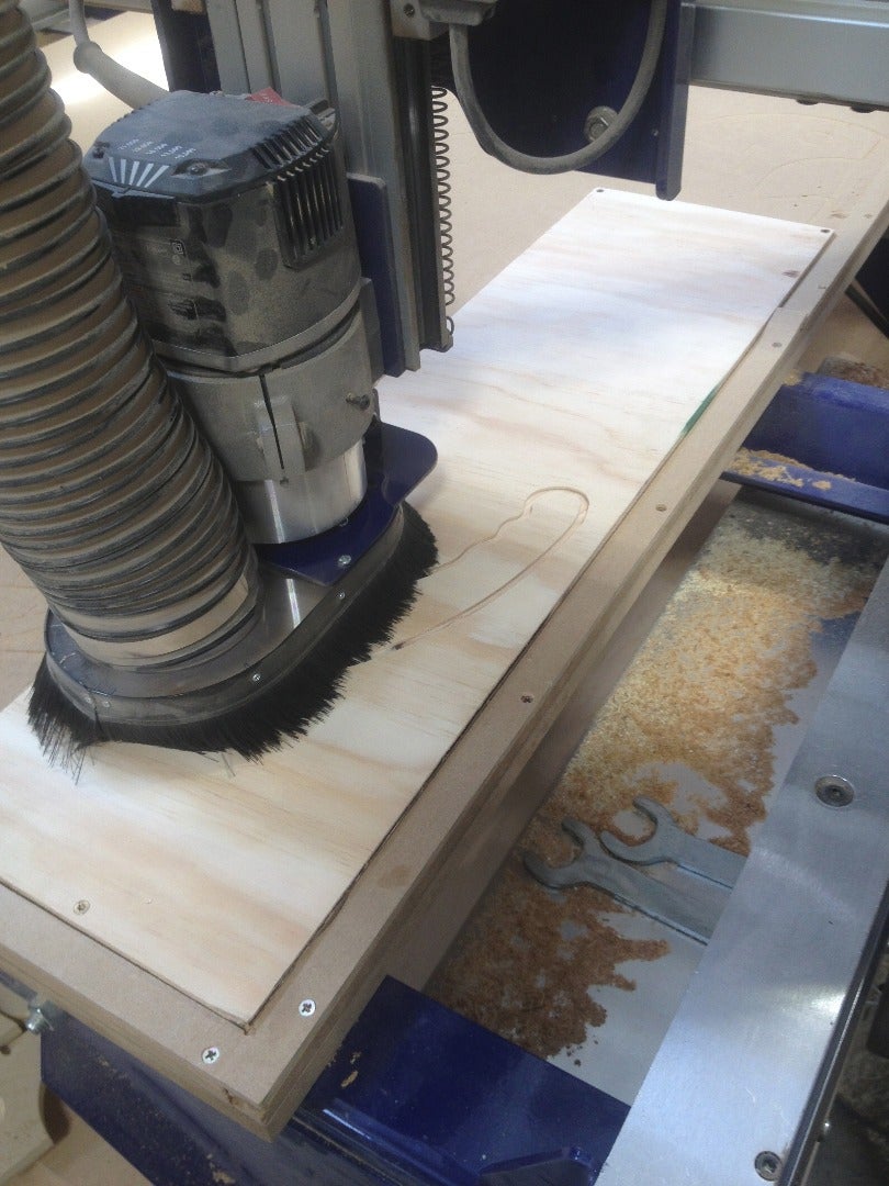

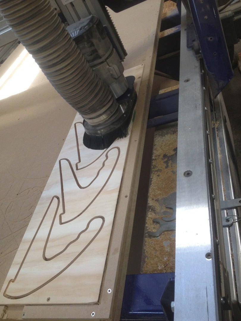

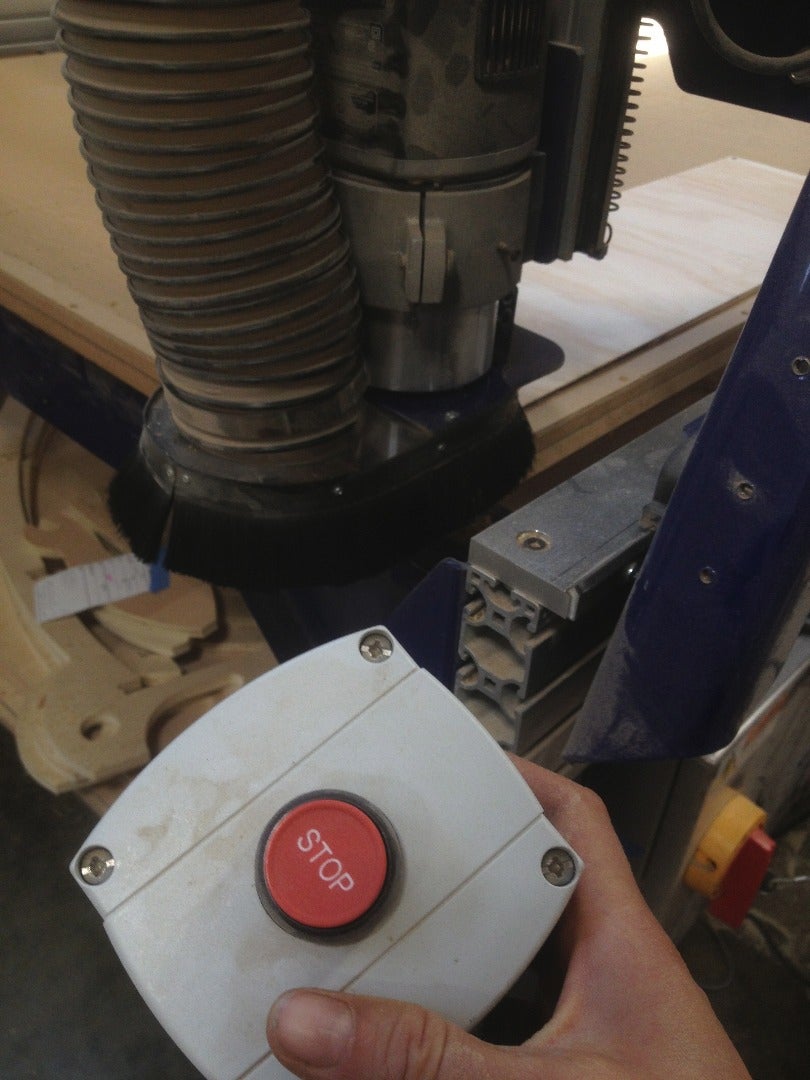

Step 8: Run the Job!
9. Run the Job!
-Press the CUT PART button on the red control panel and load file
-Start your vacuum
-Press START
-Agree to new bit, zeroed axis and tell her to run
-Stand-by with STOP switch in case something goes wrong
-Turn off vacuum when finished

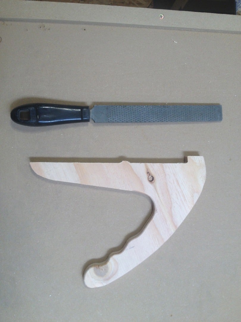

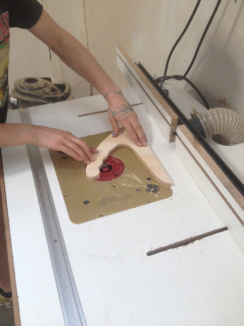

Step 9: Finishing!
10. Finishing

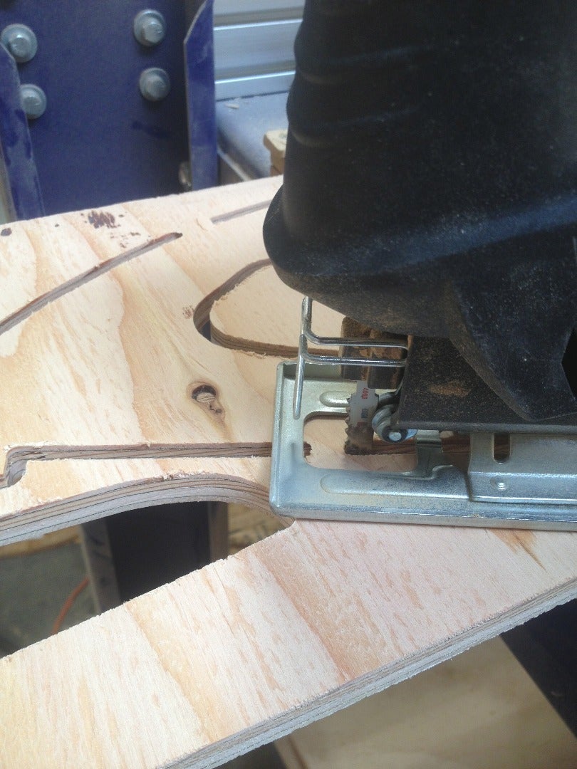

-Deinstall the material
-Use a jig-saw or bandsaw to cut out the pieces

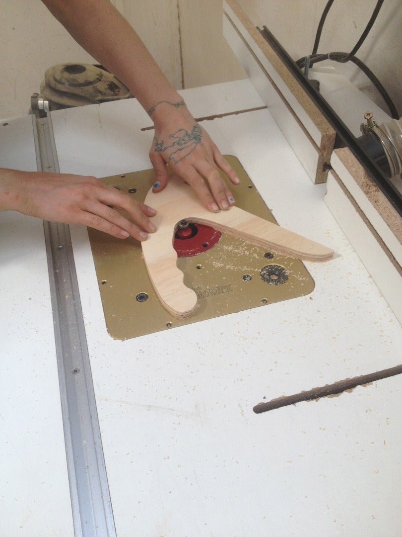

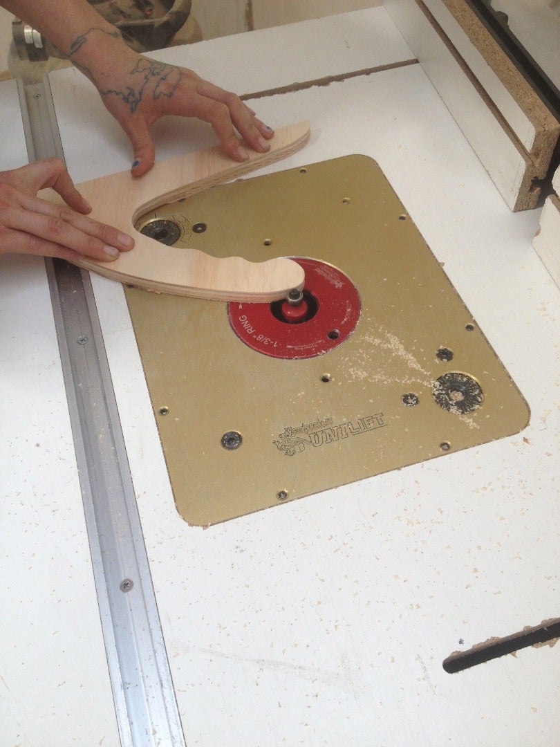

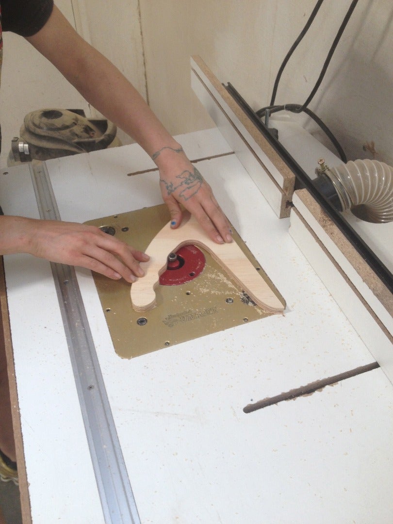

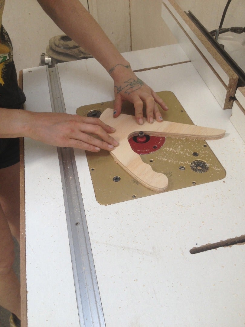

-Using a router-table, use a round-over bit to ease the edges for a more comfortable grip
-Open the router disk with two-pronged tool
-Install router bit with collet using wrenches
-Set the router to an appropriate height for your material
-Push the router going against the direction of the router’s spin (it’s spinning counter-clockwise)
-Use a file to clean the rest of the edges
-In a well ventilated area, use spray paint to make them stand out
