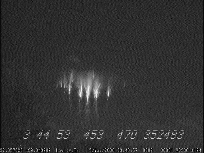

This Instructable will show you how to Capture Video of a Sprite or High altitude lightning! Now, incase you're asking yourself. "what the heck is a sprite??!!!". I'll Tell you!
Sprites are very high altitude lightning phenomena. They last for a vanishingly short time and are typically Salmon or reddish in color with bluish bottoms. They occur over large thunderstorms that generate Positive cloud to ground lightning. "+CG"
They can bee seen with the naked eye if you are for enough away from bright lights at night and the thunderstorm that produces them is over 90 miles away.
Now you could stand all night outside getting eaten alive by mosquitos in the spring trying to glimpse these fleeting phenomena.
Or!
you could set up a camera and have your computer do the work for you and have a lasting image to show and baffle your friends with!
I'm going to show you how to do the latter!

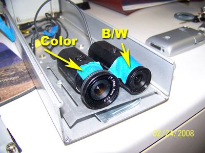

First you need a good low light camera.
I have two cameras in parallel. One color and one Black and White. you don't need a color cam to do this. In fact the Black and White is much better for this purpose. The rest of this Instructable will focus on the B/W camera.
The camera best suited to casual sprite capture cost wide vs lowlight ability is the SuperCircuits PC164c
The camera be found here. PC164c It costs about $114 plus shipping. This is the B/W camera I use
I'd also suggest an outdoor weather housing. You can build one yourself or purchase one. Either will work. Typically you need one because Even if it's not raining when you start a capture session. Odds are, if there's sprites. It's probably gonna rain sometime during the night.
You need the camera to be in a dark location. No street lights or porchlights if possible. Bugs flying through a light will trigger the motion recording software.
You'll need the camera to be on a tripod or some form of stable platform. If the camera moves from wind, bumps or vibrations the motion software will spend all night recording little squiggly stars.
Below you'll see a photo of my cameras and the tower they're mounted on. You don't need a tower! a simple tripod will work. I doesn't matter as long as the camera will stay pointed in on direction and not move around!
