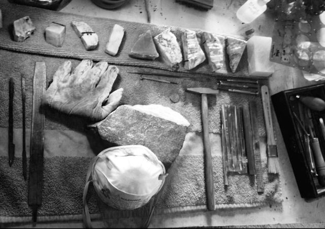

Tools for carving by hand, I use these items:
1. Face mask 2. Small hammer 3. a leather glove 4. Small piece of Alabaster Stone (Ice Alabaster in picture) 5. Needle pick 6. Coarse and fine rasps & files (small to medium in size) 7. Mini watch screwdrivers (used as chisels) 7. clay carving tools for detail since Alabaster is a soft stone.
Think safety first. Remember shop class? Use that knowledge here and protect yourself from dust, scrapes, and hazards.

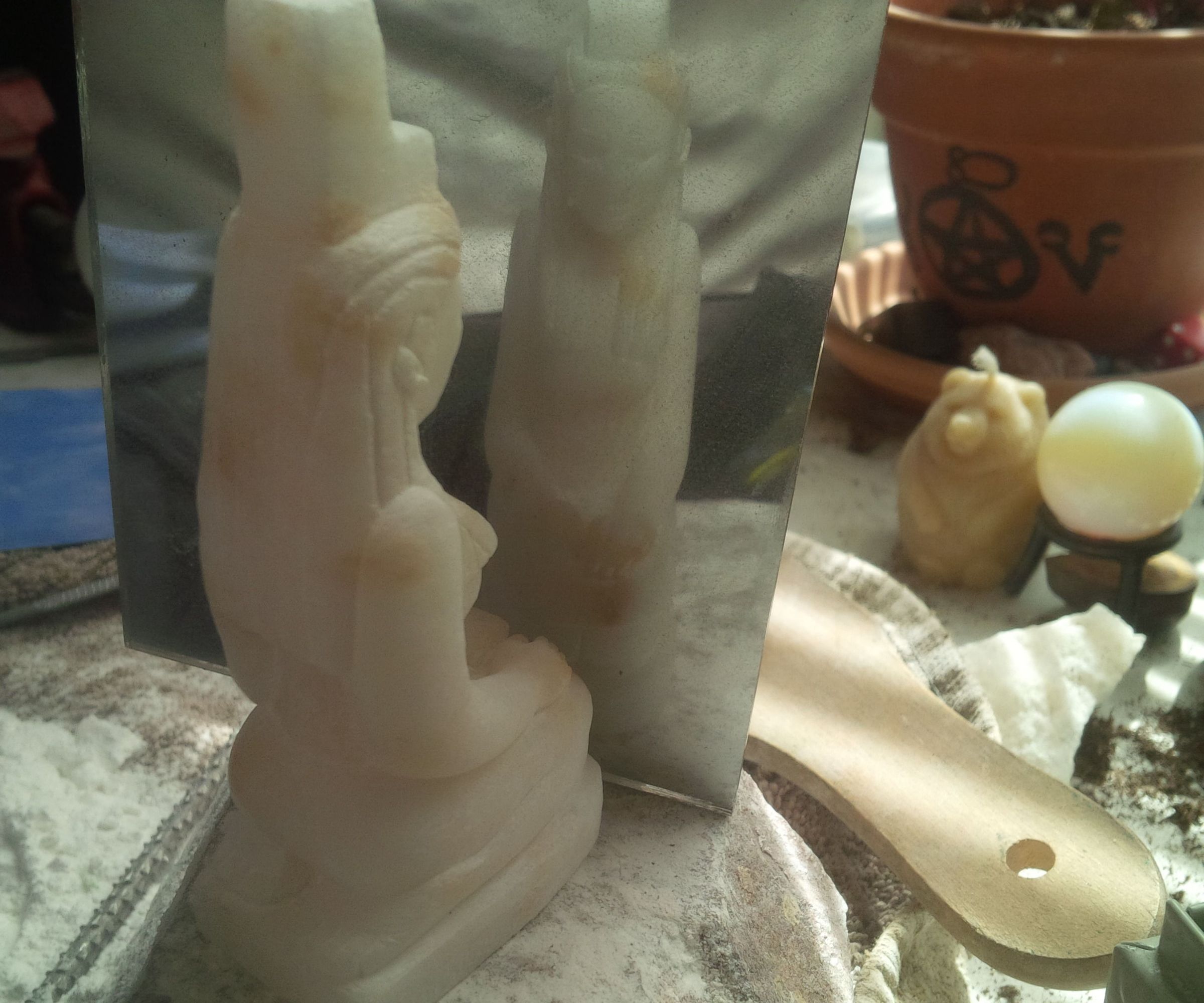

Step 8: Last Stage of the Un-sanded Statute
At this stage in the process, knowingly leaving it un-sanded, I felt like the carving was complete. I carve by hand with files and mini screwdrivers. I'm not a big fan of sanding my carvings to a glossy machine like finish. It's totally a clash of style. I like the raw natural look. However, if You would like to, after this point, continue on with the sanding to a glossy machine-like finish- feel free to do so.
Using various grit sand paper, starting with the coarsest sand paper- sand the statue. Working from there, grit by grit, until the finest grit is reached: sand all sides of the statue until desired look is reached. Buff the statue, then apply stone oil.
