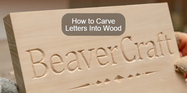

Have you ever seen a beautifully carved wooden sign and thought, "I wish I could do that"? Carving letters into wood might seem like something only experienced woodworkers or artists can do, but it's actually a skill anyone can learn with a bit of help, some practice, and the right tools. Picture yourself making a unique wooden sign for your home or giving a special gift with custom engraving. It's not just about looking good; it's about adding a personal, handmade touch that makes your projects stand out. In this guide, we'll show you everything you need to know to start carving letters into wood and begin your own lettering projects. This tutorial is inspired by the "How to Carve Letters Into Wood: A Beginner's Guide" guide from BeaverCraft Tools.

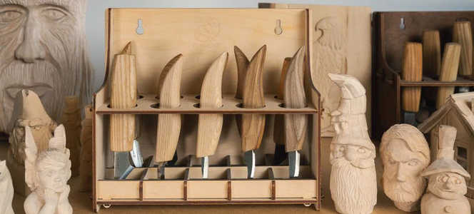

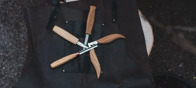

To begin carving letters, you'll need some basic tools. Here’s a quick list of what you might need:
  1. Carving knives: These come in different shapes and sizes, perfect for both the first cuts and detailed work.
  2. Chisels: Great for removing excess material and shaping the letters.

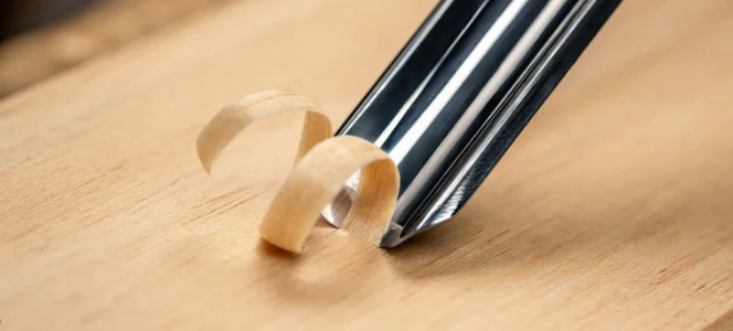

  3. Gouges: Useful for taking out bigger pieces of wood and making smooth curves.
  4. V-tools: Ideal for making clean, sharp lines.
  5. Pencil and ruler: To sketch your design and make sure your carving is accurate.
If you’re working on bigger projects, you might also want to use a router for cutting letters into wood. Each tool has a specific purpose, and having a variety of them will give you more control and flexibility in your work.

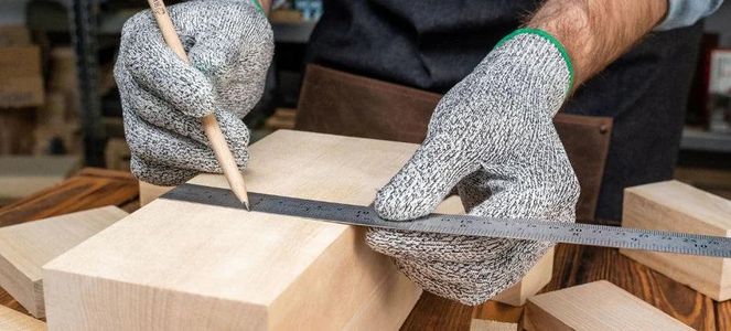

Step 3: Design Your Lettering
Here’s where you can really show your creativity. Start by sketching your design on paper. Consider the style and size of the letters you want. Do you prefer something bold and strong or more elegant and cursive? You can also use wood carving letter patterns to help you. When you're satisfied with your design, transfer it onto the wood. You can do this by tracing with a pencil, using carbon paper, or even gluing the paper pattern directly to the wood as a guide.

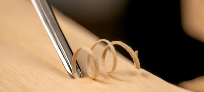

Step 4: Start Carving
Now it's time to make your first cuts! Start by carving the outline of your letters. Use a carving knife or chisel to carefully follow the pencil lines or the template you’ve made. Learning to engrave letters into wood takes patience, precision, and steady, controlled cuts.

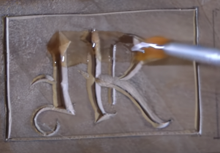

Step 5: Refine and Detail
With the basic shapes done, it's time to refine your letters. Use smaller V-tools or gouges to add details and smooth out any rough edges. Whether you're carving a single letter or a full word, take your time to get the best results.
