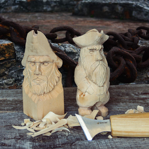

Step 3: Carve the Basic Shape
Start with larger tools to shape the main outline of your sculpture, removing excess wood. Concentrate on establishing basic forms and proportions at this stage.
Step 4: Define the Features
Bring your sculpture to life by adding details such as textures, patterns, facial expressions, or muscle definitions.
Step 5: Refine the Details
At this stage, use smaller tools to refine the intricate details of your sculpture. Precision and patience are key. Explore various carving techniques to enhance depth and add character to your work.
