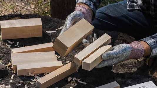

  1. Wood: Various types are suitable, with basswood and pine being beginner-friendly.
  2. Spoon carving blank: A pre-cut wood piece with the basic spoon shape and size.

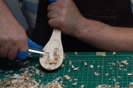

Step 3: Shaping the Spoon's Bowl
Following the removal of excess wood, commence shaping the spoon's bowl with a spoon carving knife or gouge. Choose a tool that aligns with the size and shape of your spoon project. Proceed with care, taking your time, and ensure not to over-remove wood during this process.

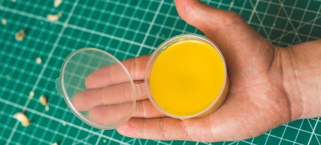

Step 6: Applying a Safe Finish
For the wooden spoon to be deemed safe for food use, it is essential to apply a food-safe finish. There are different options to choose from, including mineral oil, beeswax, or a blend of both.
