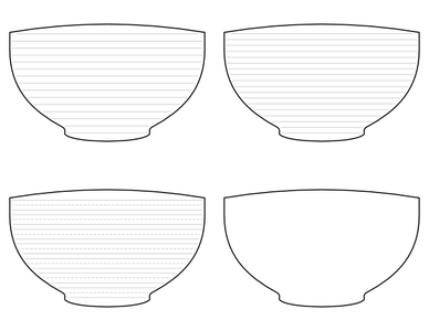

Step 2: Craft Templates for Wooden Bowl Design
Prior to making the initial cut, it's essential to have a blueprint for your bowl. Develop a template or pattern of your preferred bowl shape on paper. This visual guide serves as a reference to ensure consistency and helps you attain the desired design with precision.
