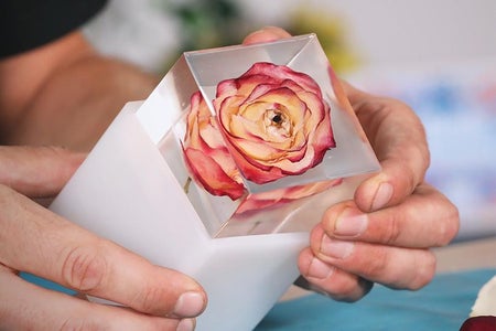

After 48 hours have passed your piece should be cured. To check if the casting is ready to be demoulded use a mixing stick to press firmly on the surface. It should feel rock solid and no marks should be left on the surface of the casting.
To be completely sure pick up the mould and feel all around the mould.
We recommend that you wear work gloves to demould the casting as the top face were the resin meets the mould can result in a meniscus or raised edge which can be very sharp.
Break the airlock by prising and loosening the mould all around the cast block, then turn it upside down and press firmly down, pushing the cube out of the mould.
It looks amazing already - but the top face will need to be flatted and polished to give it that incredible glass like appearance.

Step 8: WOW - Your Finished Rose and Resin Paperweight!
There you have it - a stunning rose and resin paperweight - it's classically beautiful! The mould has given us a smooth surface to the casting and the top face has come up beautifully.
