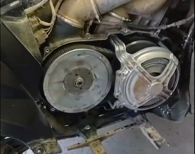

Step 8: Remove Clutch Basket and Release Tension
The clutch basket is held on by 4 10mm bolts 1 in each corner of the basket the top right and bottom left bolts are slightly longer. To remove this part you will need to remove these 4 bolts.
To be able to remove the primary clutch you will need to remove the tension on the belt. The 2 longer 10mm bolts from the basket will be needed for this, start tightening them into the 2 threaded holes in the secondary, this will spread the plates apart releasing the belt tension.

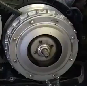

Step 9: Remove Primary Clutch
To remove the primary clutch you will need a 27mm socket and an impact, for this to work the quad will need to be in park or it will roll away from turning the clutch.
After removing the nut you will be able to slide the washer, primary, and collar off of the shaft.
When removing the primary clutch always check the face for damage.

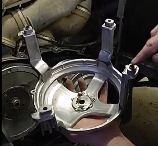

Step 10: Disassembling the Primary Clutch
The primary is held together by 8 Philips head screws. Once these are removed you will need to pull the cover off and remove the cam it should just slide right out.
Step 11: Replacing the Clutch Weights
Remove the 8 32gram clutch weights from their slots and add the 16gram replacement weights.
