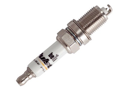

Step 4: Put the New Plug in Place
Your manual will tell you which ones you want. It’s best not to try to save a few bucks here by opting for a cheaper version – your manufacturer chose the right ones for a reason.
Place your spark plug in your socket and carefully guide it in to place. It’s not hard to break or bend these, so you want to be gentle, even going so far as to tighten it by hand at first (using your hand on the extender). Once you’ve got it in place you can switch back to the ratchet to tighten it further.
It’s important to note: you want it tight, but not too tight. Excessive torque is not the goal here, and in fact that could be damaging to your new plug. But, when it feels like it’s in place and not going anywhere, put your spark plug lead back in place, make sure the edges are sealed and that’s it!
