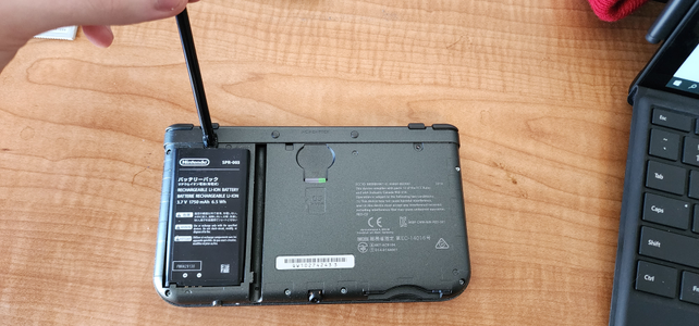

Step 3: Take Out Old Battery
Using either the stylist or your nail, remove the battery from the top. Within the picture, you can see where to place your stylist or nail.
Step 4: Place New Battery
Matching the connections on the battery and the Nintendo 3DS. The positive connection is on the left with the negative on the right.
