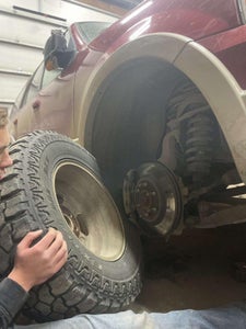

Step 5: Place Your New Tire on the Studs of Your Car

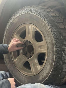

Step 6: Hand Tighten Your Lug Nuts Back On
Step 7: Use Your Impact to Tighten the Lug Nuts Snuggly
You should tighten them in a star like pattern to make sure they get tightened evenly
