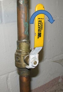

1. Locate the main water shut off for the house or apartment. It will most likely be located in the basement of a house or duplex. There will be one of two types of valves ,a ball valve (see picture 1) or another style of valve shown in picture 2.
2. Close the ball valve off by gripping the handle and rotate it clockwise. Move the handle until it has moved a full 90° from the original position. For the other style of valve pictured, grip the round handle and turn it in a clockwise direction until is fully closed.

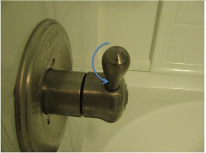

2. Once the lever is removed the screw can be found (see picture 2). Try to evaluate what size allen wrench is going to be needed. Insert that wrench into the hole. To make sure the allen wrench is seated into the set screw, wiggle the wrench back and forth. If the wrench does not move at all you have selected the appropriate size wrench; if the wrench moves without resistance select a different size. Select the wrench that moves the least. For the other style of trim, the set screw can be found in the recess under the lever (see picture 4).

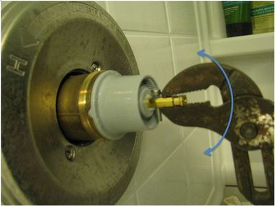

Tip: If the cartridge will not come out, the cartridge can be removed with tongue and grove pliers (shown in picture 2), or the needle nose pliers may also be used.

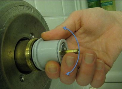

1. Once the cartridge is installed, replace the bonnet. Tighten by hand only, even if it was necessary to loosen the bonnet with pliers, still tighten by hand (see picture 1).
