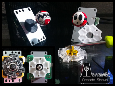

By default most joysticks come with a square gate, in this tutorial I will show you how to swap them with an Octagonal gate. - For both Sanwa and Seimitsu joysticks.

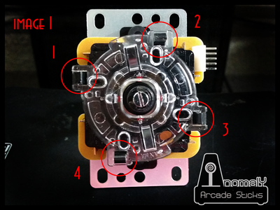

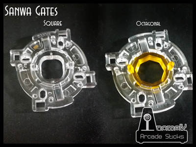

Sanwa Stick
- Push the first two tabs while lifting the gate as shown in the image 1, then the third, and the forth tab.
- The gate will come off and you will see the image 2
- Then line the tabs with the new gate and push it on. You're done.

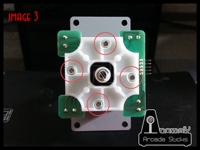

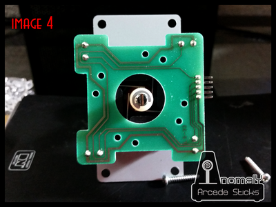

Seimitsu Stick
- Unscrew the 4 screws as seen in image 3.
- Pull off the gate and it should look like image 4.
- Screw on the new gate.

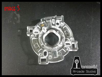

Additional info
- You can rotate the inside of the gate so that it has a different angle, for instance you can rotate the square so that it is a diamond. This is mostly good for games with just up, down, left, right. See image 5
