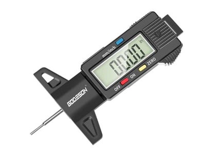

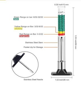

Familiarize yourself with your tread depth gauge. Most gauges have a probe that sticks out from the bottom and a scale that reads in 32nds of an inch or millimeters. Some digital models display the depth on a screen.
Step 4: Insert the Gauge
Place the base of the gauge flat against the tire tread. Push the probe down into the groove of the tire until the base of the gauge is flush with the tire tread. For manual gauges, ensure the probe is pushed in as far as it can go.
Step 5: Read Your Gauge
For a manual gauge, read the scale where it meets the slide. This will give you the tire tread depth in 32nds of an inch or millimeters. A digital gauge will display the reading on its screen.
Step 6: Read & Interpret the Results
- 6/32" or More: Your tires are generally considered safe.
- 4/32" to 5/32": Start considering replacement soon, especially if you drive in wet conditions often.
- 3/32" or Less: It's time to replace your tires for safety.
