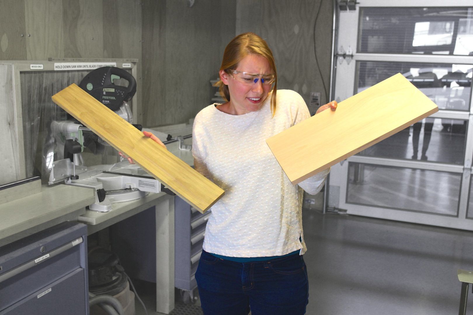

Introduction: How to Choose Lumber
Choosing lumber can be tricky! Even after you've decided on a type of wood and calculated the dimensions you'll need, every board is different and it takes time and patience to get lumber that will really make your finished project sing.
The Three Biggest Tips
- Unless you're just looking for material inspiration, always go lumber shopping with a plan! Lists and sketches are both great.
- Always get to the lumber yard or hardware store with plenty of time- spending an extra 30 minutes now can save you hours of project time later!
- Prepare to be flexible! Based on the availably in the lumber yard, you might want to choose a different kind of hardwood or adjust some dimensions. Be open to creative opportunities and don't be disappointed if you can't find exactly what you had in mind.

No board is a perfect rectangle but your projects will go much more smoothly when you use boards that are close to rectangular. If you imagine a board as a rectangle with three dimensions (width, thickness, and length) you can picture how a board could warp along any of those three dimensions.
The best way to check for a curved board is by "sighting" several edges. Rest one end of the board on the floor and hold the other end at about face level. Close one eye and look along the nearest edge- it should look straight (don't worry about perfection, if you think it looks straight you're good to go). Rotate the board 90 degrees and sight along another edge. Check both ends for cupping.
Note: Cupping can actually be desired in certain decking configurations to prevent the edges of the boards from causing trip points as they age.
Pull boards out from the racks, sight the edges, and create easily accessible piles of acceptable and reject boards. Be conscious of other shoppers and employees! Double check that you're not blocking an aisle or going to clock some poor unsuspecting soul if you spin around with a 10ft 2x4.
