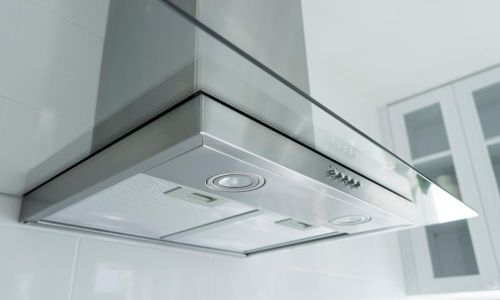

Step 1: Remove the Filter From the Hood
Remove the filter from the hood. Usually, there will be a small clip that locks the filter to the hood, twist it and the filter will be ejected from the hood.

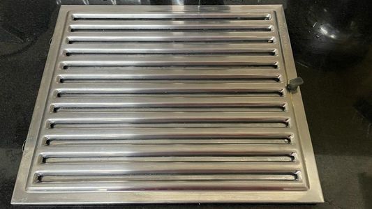

Step 2: Sprinkle Caustic Soda
Place the filter inside a basin and sprinkle a tablespoon of caustic soda on the top. If you don't have caustic soda, you can use Drainex or any other drain cleaner powder.
Step 3: Pour Hot Water
As soon as you pour hot water, you will see the grease and grime dissolving into the water. It honestly looks quite satisfying. Leave it for an hour.
Avoid pouring boiling water because caustic soda and hot water together may cause pitting on stainless steel.
Step 4: Clean the Filter in Running Water
Clean the filter in running water and your filter will be as good as new.
