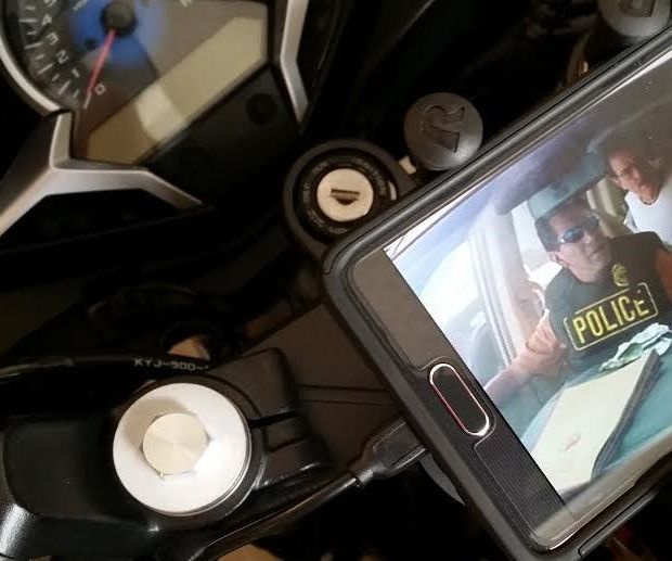

Take the motorcycle for a short ride to work the lubricant into the chain. I usually ride for about three miles on clean, paved roads.
See, I use the phone mount from my previous instructable for GPS, not Netflix. ;)
