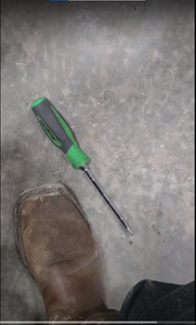

Philips screw driver

Step 1: How to Remove the Carburetor
To remove this carb, there is two bolts that have to be taken out with a philips screw driver, then you have to remove the fuel line with a pliers and pull the clip up the line, next take off the throttle cable by twisting the carb to the sky.
