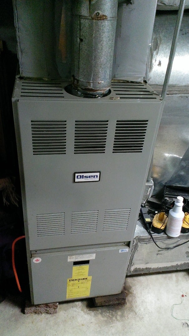

Owning a home is a large responsibility that requires maintenance to some expensive systems. One of the most important is your furnace. Your furnace controls your heat. In order for your furnace to run properly, your burner needs to be cleaned on a yearly basis. As far as my interest in this topic goes, my father does this for a living. As a kid I would travel with him to jobs and watch as he worked. Eventually as I got older I began to do some of the work myself. Although I'm not a professional like my father, I'd like to pass some of the knowledge I've learned over the years to teach beginners how to clean a burner to ensure the proper running of your furnace.

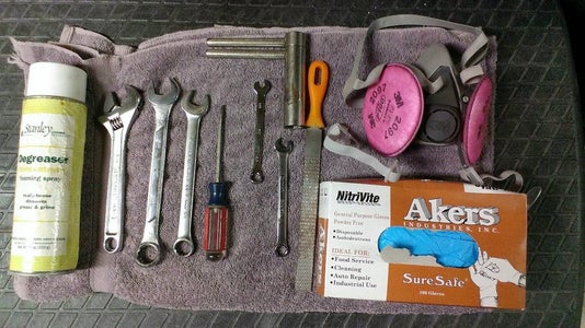

Step 2: Equipment Needed
- Respirator and or Dust Mask
- Rubber Gloves
- Foaming grease cleaner
- Common Tip Screwdriver
- Nozzle Wrench
- File
- 3/8 Wrench
- 7/16 Wrench
- Adjustable Wrench
- 5/8 wrench
- 3/4 wrench

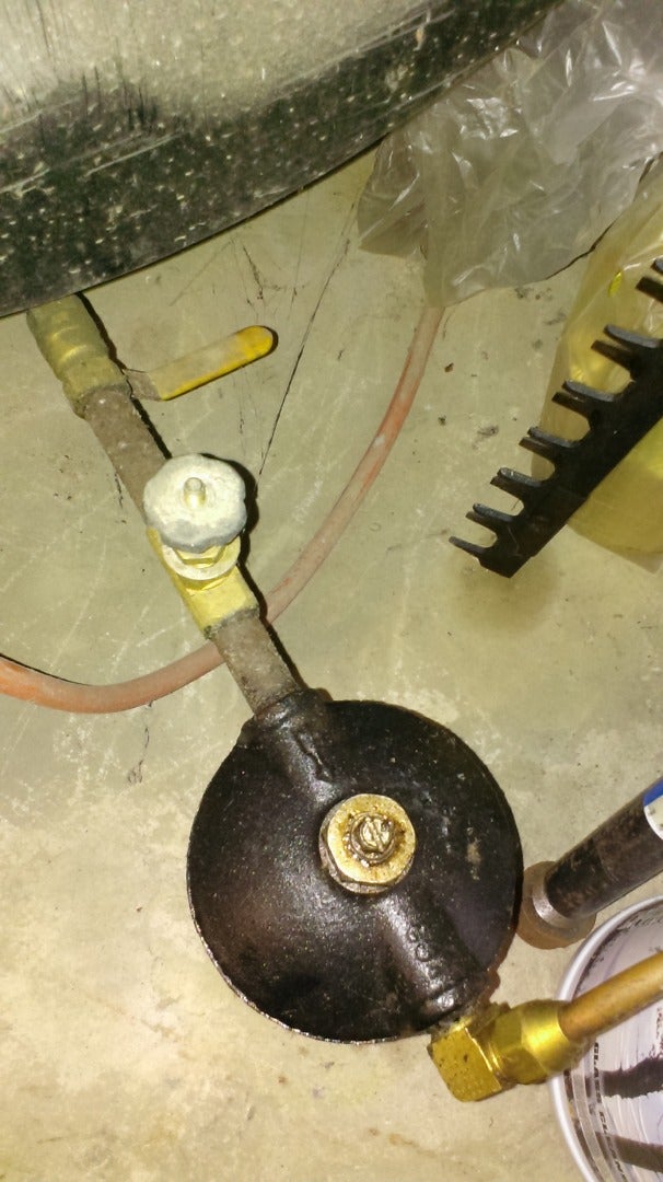

Step 4: Turn Off Fuel Valve on Oil Tank
- Turn yellow valve next to oil filter canister to off position.

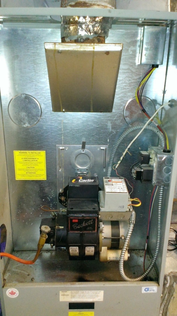

Step 6: Remove Burner Access Panel

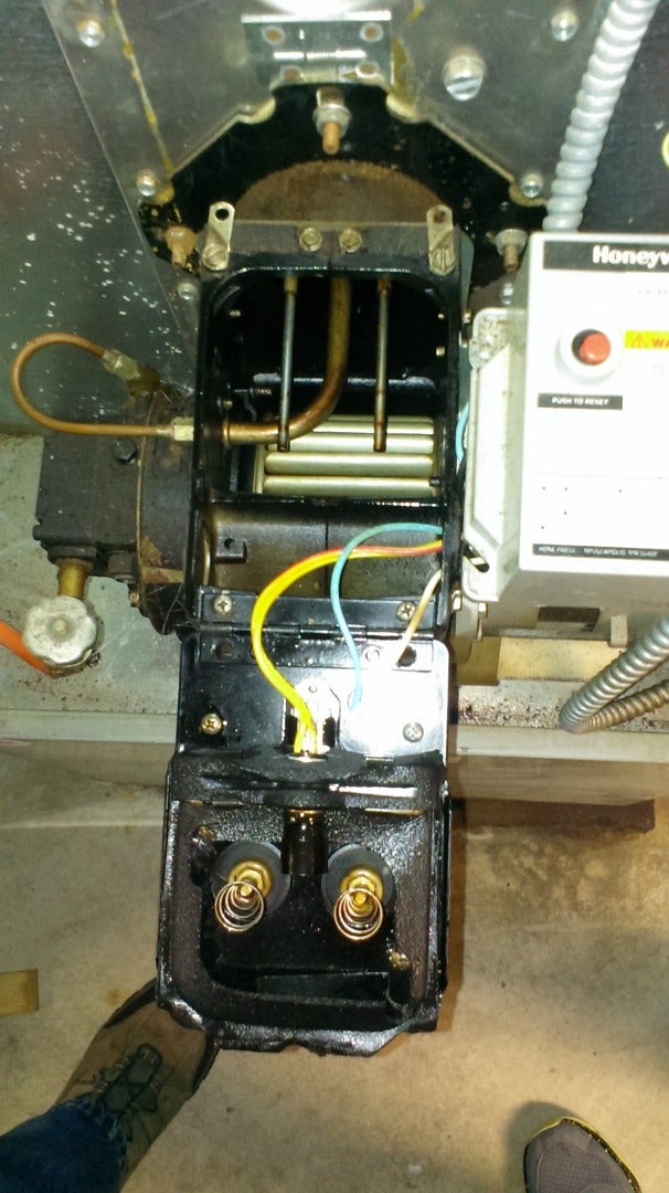

Step 7: Open the Transformer
- Loosen transformer tabs with flat head screwdriver, moving tabs towards furnace.
- Open transformer

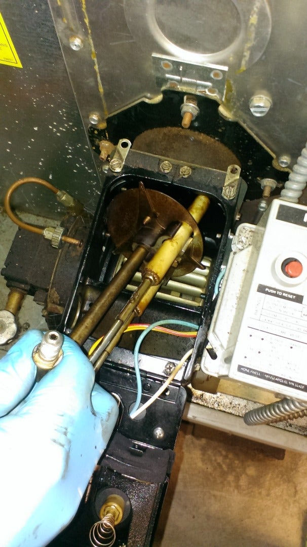

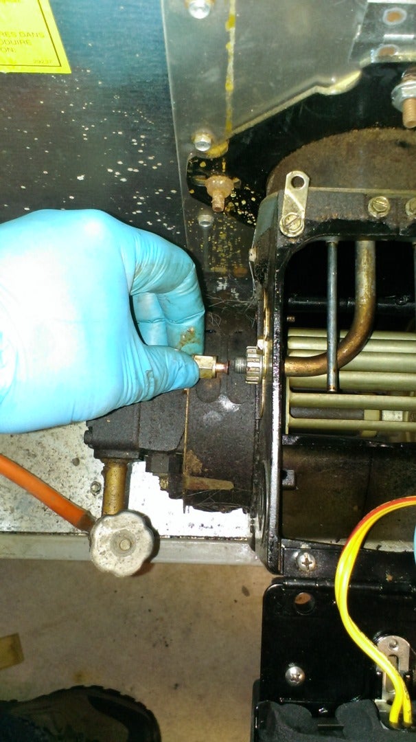

Step 8: Loosen Oil Line
- Taking your 7/16 wrench, loosen oil line from pump to nozzle assembly.
- Remove nozzle assembly nut.
Step 9: Remove Nozzle Assembly
- Turn nozzle assembly to right towards interior of burner and lift out of the burner.

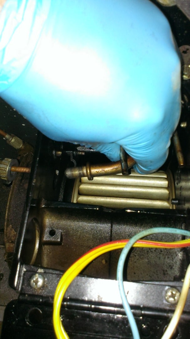

Step 10: Nozzle Assembly: Nozzle Removal
- Take 3/4 inch wrench. Put wrench on nozzle assembly.
- Take 5/8 inch wrench. Put wrench on nozzle and loosen.
- Remove Nozzle

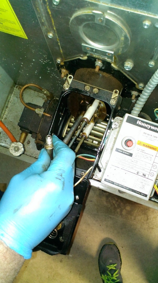

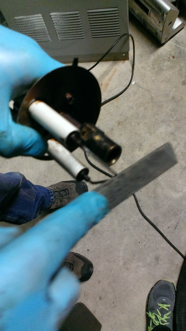

Step 11: Clean Nozzle Assembly
- Apply foaming grease cleaner to nozzle assembly. Let sit for 5 minutes.
- Take rag and wipe down entire assembly removing residue.
- Taking your file, file electrode points. (Make sure electrode gap is approximately 1/8 inch.
