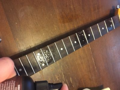

Step 5: Cleaning/Prep to the Fretboard
Once the frets are clean, take the cleaner/prep bottle from your cleaning kit, and apply/spray to the fretboard.
After applying, work in the prep by going up and down the fretboard with the microfiber cloth to saturate the entire fretboard. After rubbing the fretboard with the cloth, wait until the fretboard is no longer saturated.
Step 6: Deep Conditioner
After removing the dirt and grime from the fretboard with the cleaner, apply deep conditioner to the fretboard, then wipe up and down the fretboard with the microfiber cloth to apply the conditioner across the entire fretboard. After using the microfiber cloth, wait until the conditioner has completely soaked into the fretboard and no longer saturated.

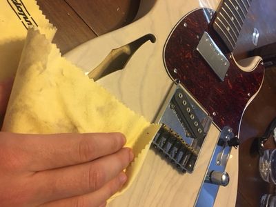

Step 7: Guitar Polish
After applying the conditioner, spray 2-3 pumps of the guitar polish onto a clean microfiber towel and apply across the body of the guitar. Not the fretboard, or any hardware. Once you have applied the polish, take your microfiber towel, flip it over, and buff the finish across your guitar. This will leave the guitar looking shiny and new.
Step 8: Guitar Wax
After applying the polish, take a guitar wax and apply about a dime sized drop onto a clean microfiber towel and apply to the body of the guitar. Apply only to the body, do not get this on any hardware. Rub the wax onto the guitar until wax is absorbed into the guitar. The wax will fill up any minor scratches, or any other damage done to the guitar.

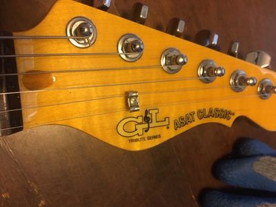

Tighten the tuning knob to start winding the string. For the first wind, you will want to make sure the excess string goes under the attached portion of the string. After this, you will make winds above the excess string. Also, it is important that the string is being wound correctly. COUNTER CLOCKWISE. Make sure all your strings begin like the string shown above.
After tightening your string, making sure there are about 2-3 winds on the tuning machine head. Cut the remaining string off with a string cutter, or wire cutter.
After following the previous steps, this will be the result of the low e string. Repeat the process until you reach the B string.
Step 11: B and E String Tree
Once you have reached the B string, make sure the string sits under the string tree (metal piece in middle of headstock). The same process will be done for the high e string.
