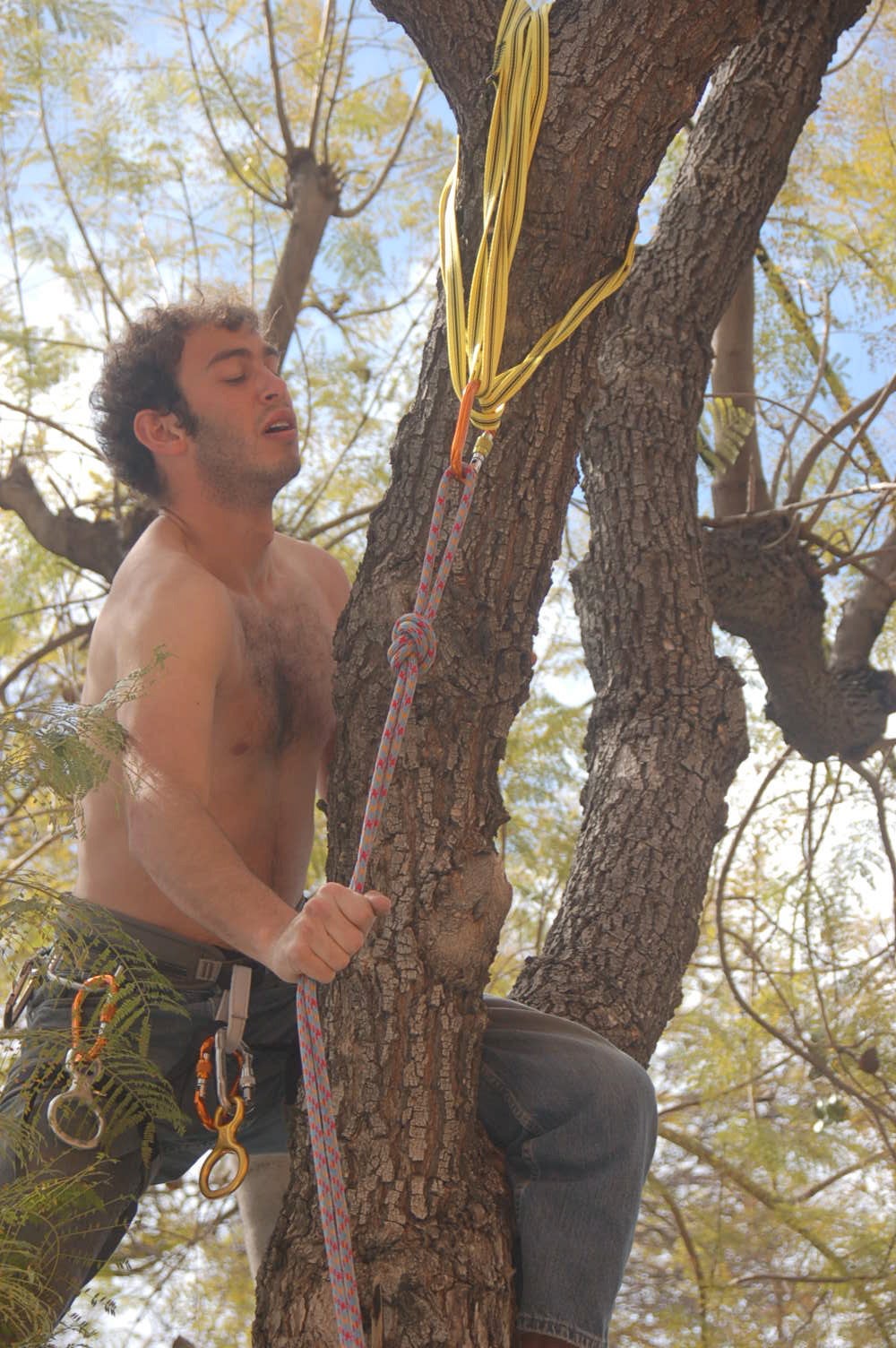

Clip your carabiner into the prussik. You and the tree are now mechanically linked!
Step 5: Climb the Tree
Now start ratcheting yourself up the rope, up the tree.
I alternated between standing on my foot, in the foot-prussik,
and hanging from my harness, from the hip-prussik.
While standing on my foot, I slid the hip-prussik upwards.
Then I rested on it and it auto-gripped so I could loosen and slide the foot prussik upwards.
It was a little awkard to only ever have one foot supported. Also, you definitely can't do this barefoot.
When you get to the top, enjoy! Have a tea party or something, enjoy the view, enjoy the breeze
(especially if it's as hot as LA was, that day.)
