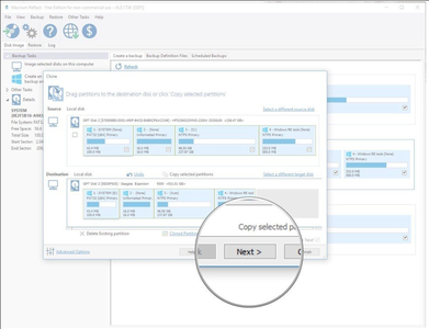

The next step the software will have you do is to select the source drive. The source drive should be the main drive of the computer that you are on.
Step 3: Select Target Drive
After selecting the source drive then next step would be to select the drive you are cloning to. This will become available once you plug the replacement drive to the computer. This will be done via usb to SATA cable if your replacing with a 2.5 SSD or M.2 NVME reader.
If your source drive has partitions like it is in the picture you will have to drag that over to the target drive like it is done in the picture. The next still will be used for situations where the target drive is of a larger size than what you currently have installed. If the target drive is the same size you can skip step 4.

When it comes to cloning to a drive larger than what is originally in the computer there is an extra step. That process is expanding a partition since when cloning it doesn't automatically fit to the size of the target drive. So from the picture what you'll do is select the C partition and click Cloned partition properties. In the properties menu you will expand that partition to include the rest of the free space thats one the drive. Once this is done you will be then able to move onto the finishing step.

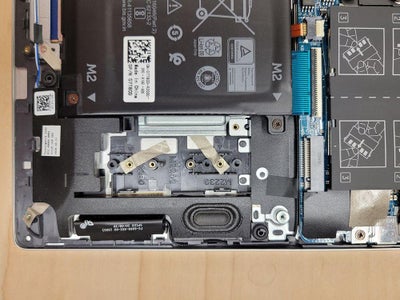

This step will be performed in reference to the guide that should have been looked up regarding disassembly of the bottom of your laptop. Once disassembly is complete you will want to remove the old drive from the computer. If the old drive is a 2.5 HDD and your are replacing with a 2.5 SSD you will be placing the new drive in the same location that you took the old out. If you are replacing with a M.2 NVME then you are looking for the M.2 connector on the board itself. Reference to the disassembly guide maybe needed. But you are looking for something like what is pictured above.
