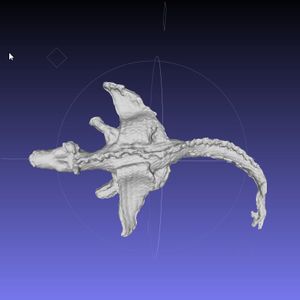

Once you have your .obj file of your model open it up in Autodesk Meshmixer. Here you can clean up your model. I had parts of the floor included in my model so I was able to delete the extraneous parts. Once that was done I used the Inspector feature in the program. Since the capture did not create an underside for the dragon there is a big hole. The Inspector tool was able to create a bottom for my dragon and filled in the other holes as well (and fix all the other things that were wrong with my model.) Here is a link to some tutorials on how to use Meshmixer.

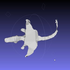

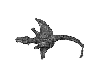

At this point I realized that my file was really huge (over 20Mb) whereas most of the other models that I have seen posted on Instructables were a couple of Mbs. I didn't know were I went wrong. I browsed through a number of 3D printing instructables and came across Don Whitaker's 3D fractal. In it he describes reducing the number of polygons and smoothing the mesh using MeshLab. I basically followed step 7 of his instructable and used Merge Close Vertices, Re-Orient All faces Coherently, Quadric Edge Collapse Decimation, and HP Laplacian Smooth. I then selected Close Holes then Export Mesh As STL File Format for printing. You can also use MeshLab to resize your model but I can't remember if I did that. Now your model is ready to print!
