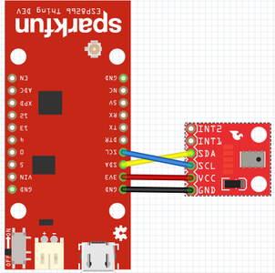

Step 3: Setting Up Hardware
Wire hardware according to the above picture
Plug USB into laptop and ESP8266
