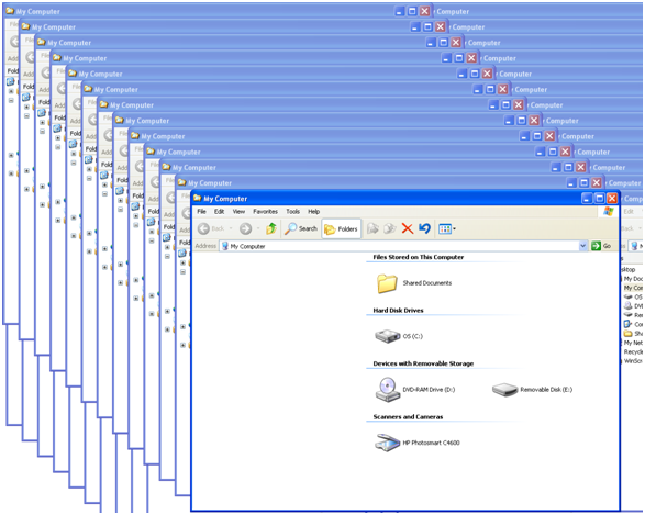

Step 2: Final Code
This is the final code:
set wshshell = wscript.CreateObject("wscript.shell")
x = InputBox("What would you like to spam?", "Spam Bot")
y = InputBox("How many times to spam? (over 200 will crash most computers)", "Spam Bot")
WScript.Sleep 1200
For z = 1 To y
WshShell.SendKeys x
WScript.Sleep 75
WshShell.SendKeys "~"
WScript.Sleep 10
Next
To finish, put this into your notepad document and save it as SpamBot.vbs
It must be saved as a .vbs to use the VBScript and make it work.
Change the file type from 'Text Document' to 'All Files'.
When you would like to spam someone, run this program.
